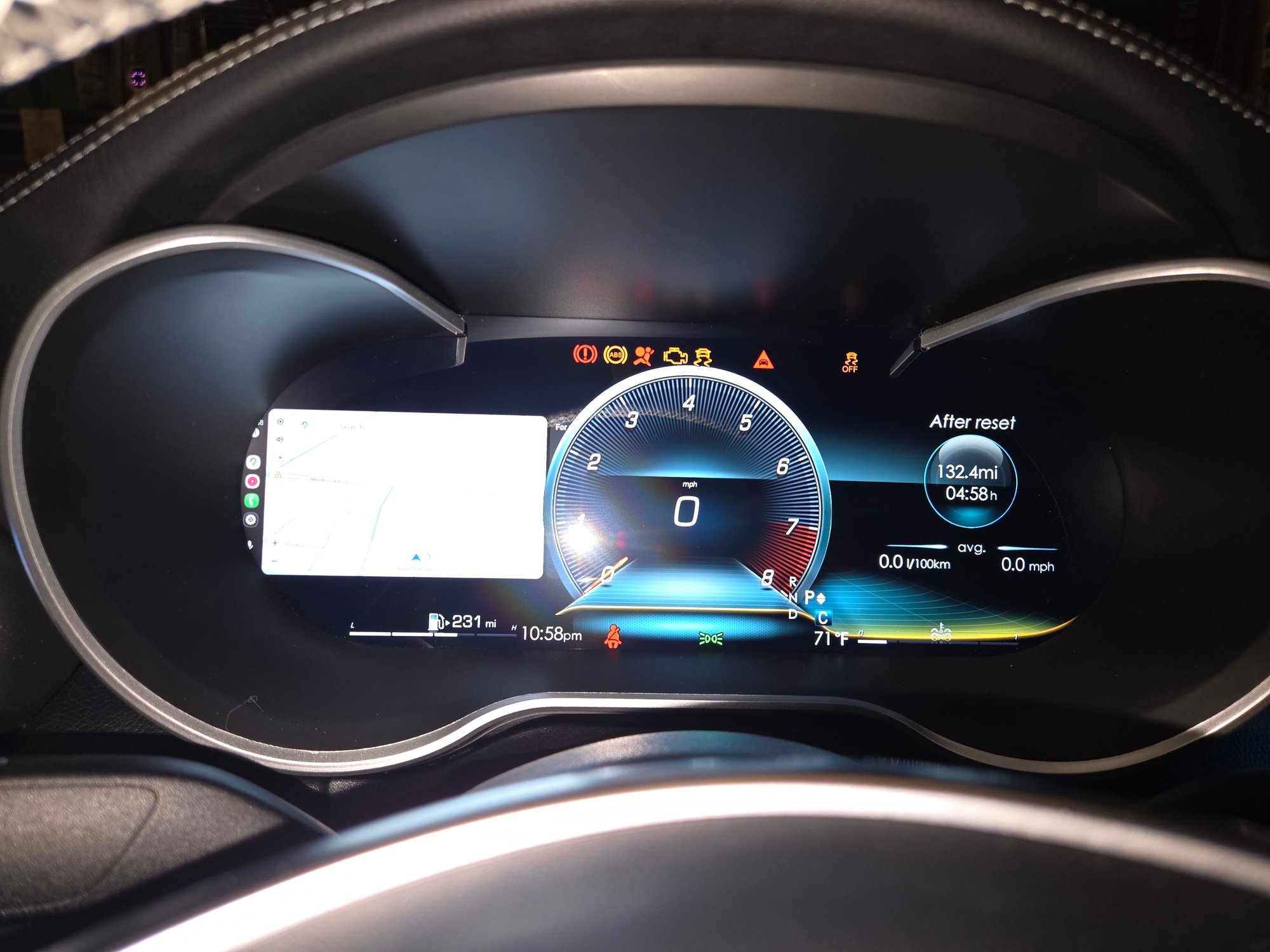

Cluster Demo with Upgraded Software

I would not take apart your oem cluster just yet. This digital cluster is still missing many icons, settings and required messages.
For example, if you start your car, open the driver door and shift into reverse. There should be a warning message. There is no "hands off steering wheel" warning when in distronic cruise. There is no adaptive high beam assist icon.
I am not sure what year c class they are using for their testing, but some settings are not for the 2015 W205.
Still a beta work in progress. Don't fully install this for your safety.
