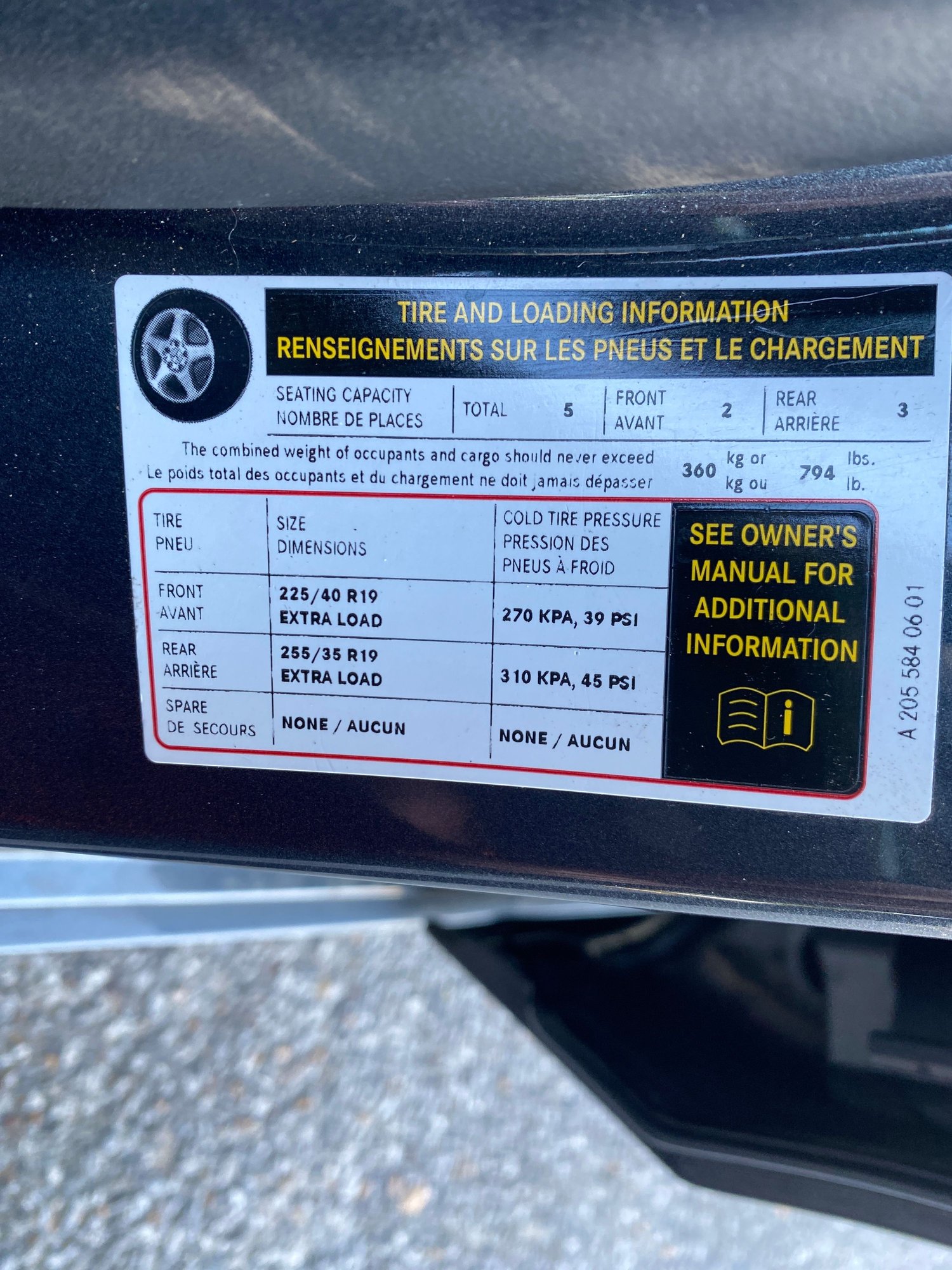

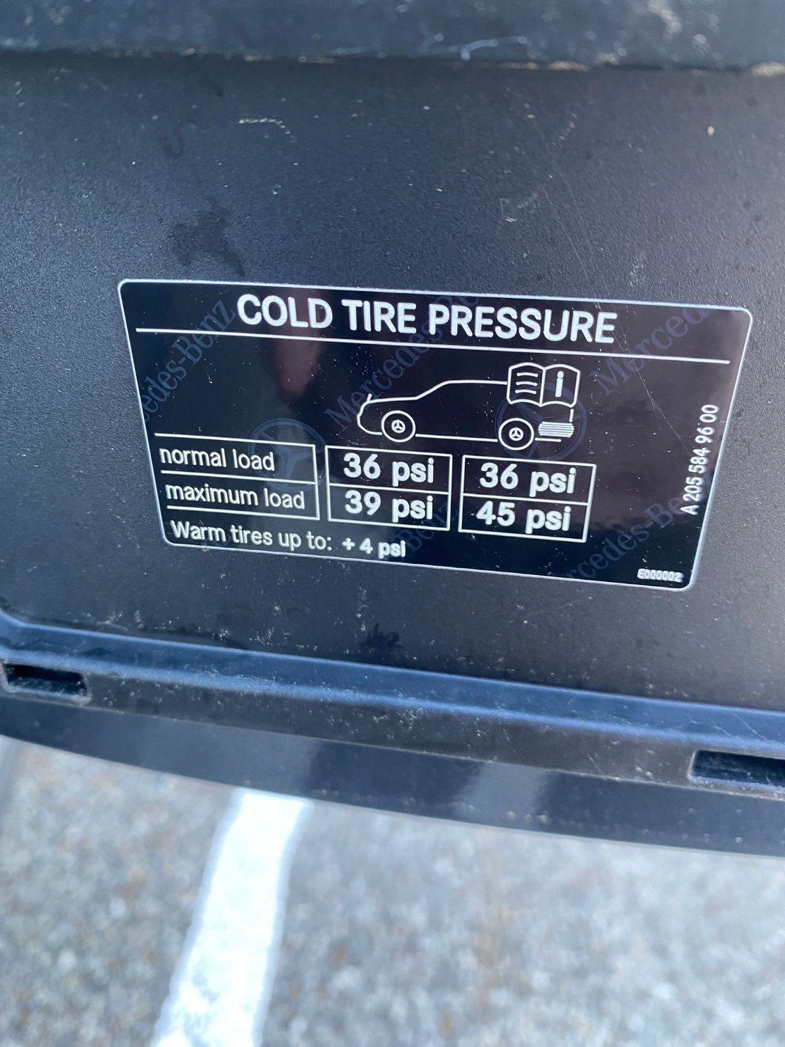

It’s a little confusing. here’s the info.
Fuel Cap
and sticker from driver

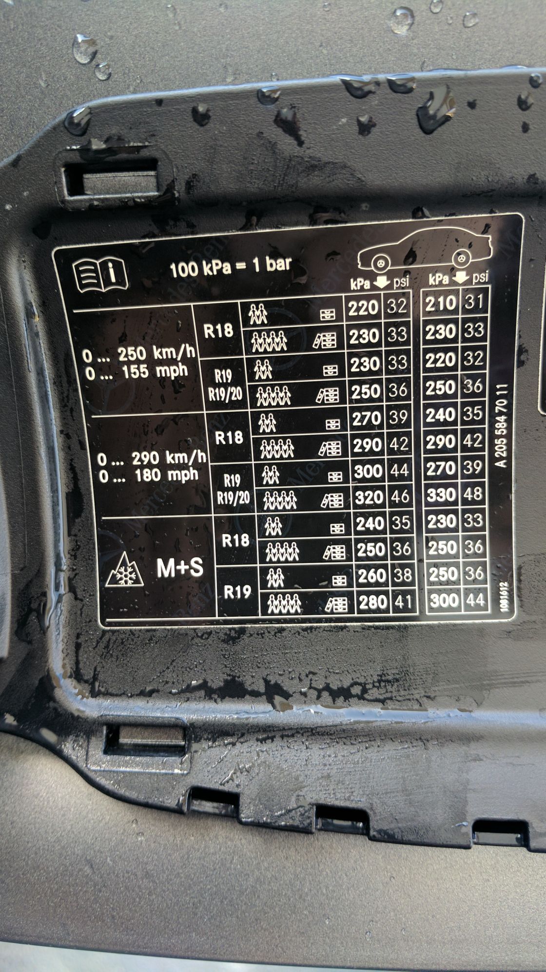

Oh you have that version of the sticker, I see, then it is pretty much the same as the door sill, I am not around my car but for reference these values are what looks like on an AMG C 63 S: https://mbworld.org/forums/attachmen...sure-chart.jpg
Although my car doesn't have as many pressures shown being a C 43 but anyways, correction from my previous post I do 37s not 39s (realized the typo) on all four corners tires,
You don't have high load in the rear right and/or passengers?
Normally the fronts and rears are set differently but for my cases I prefer them all at the same amount.
The higher PSI is usually because of the weight of the engine but that is only an issue with the 18s from what I experienced since you have 19s, follow the front lesser psi than rear) and you can add and decrease as you see fit. Although MB usually likes to flip it say for example the rears are higher than the fronts.
According to your public profile, you listed you are from LA and from what I see the temperatures are around 23-26C or 58-61F.
Why don't we start with cold 37 fronts and cold 36 rears : )
It is up to you if you want to get the wheels checked if they are bent or not and then balanced again, I am not sure if it is necessary but if you really think you bent them then get them straightened, again...

Oh... um do cold tire pressures 37-39 all around then.

Don't do 45 maximum load when cold, if I recalled correctly, stock oem runflats summers are conti? If so the max inflation pressure might be 50, you risk a blowout if the weather suddenly gets warm and then goes beyond 50. Plus the ride quality will be super trash anyways and you have excess middle wear.
