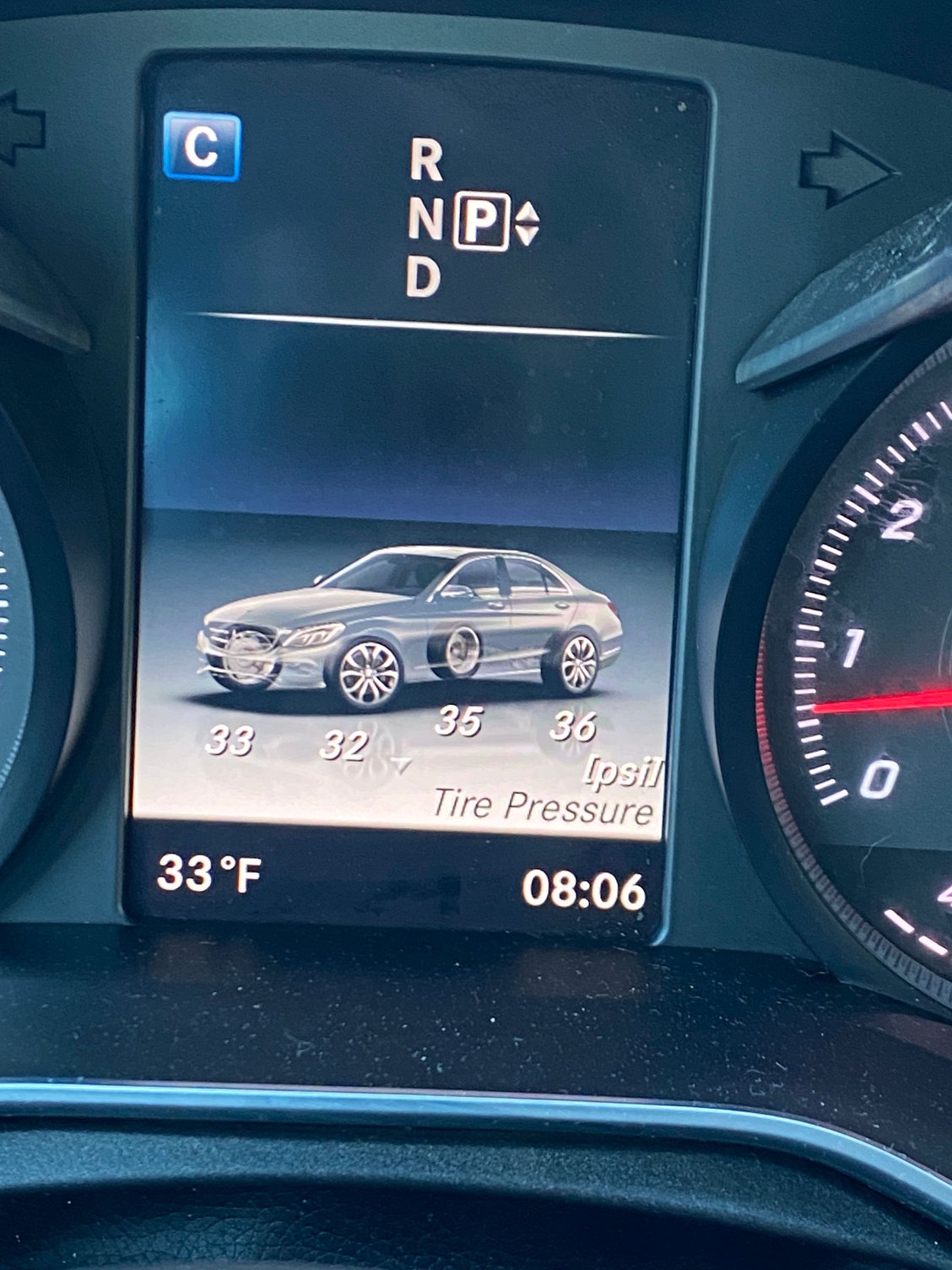

I have 19 inch wheels on this car and here’s the read out. I started the car only drove for about 2 miles. It’s 33° here
pretty sure I’ve already bent the rims. It seems unlikely that one of the wheel weights came off, but I suppose anything is possible. The only thing I can do now is have it rebalanced.

Seems a bit too low to me, what does it show on the fuel cap door asking because the values on the C 400 is different to the C 43, I do 39 all around for my winter 19s for example. It is not the best but the best for me in terms of comfort and handling. Usually front and rear values are different.
Man, I should’ve checked those guys. I thought they would’ve made sure the right tire pressure was in.
Man, I should’ve checked it. I thought they would’ve made sure the right tire pressure was in.
