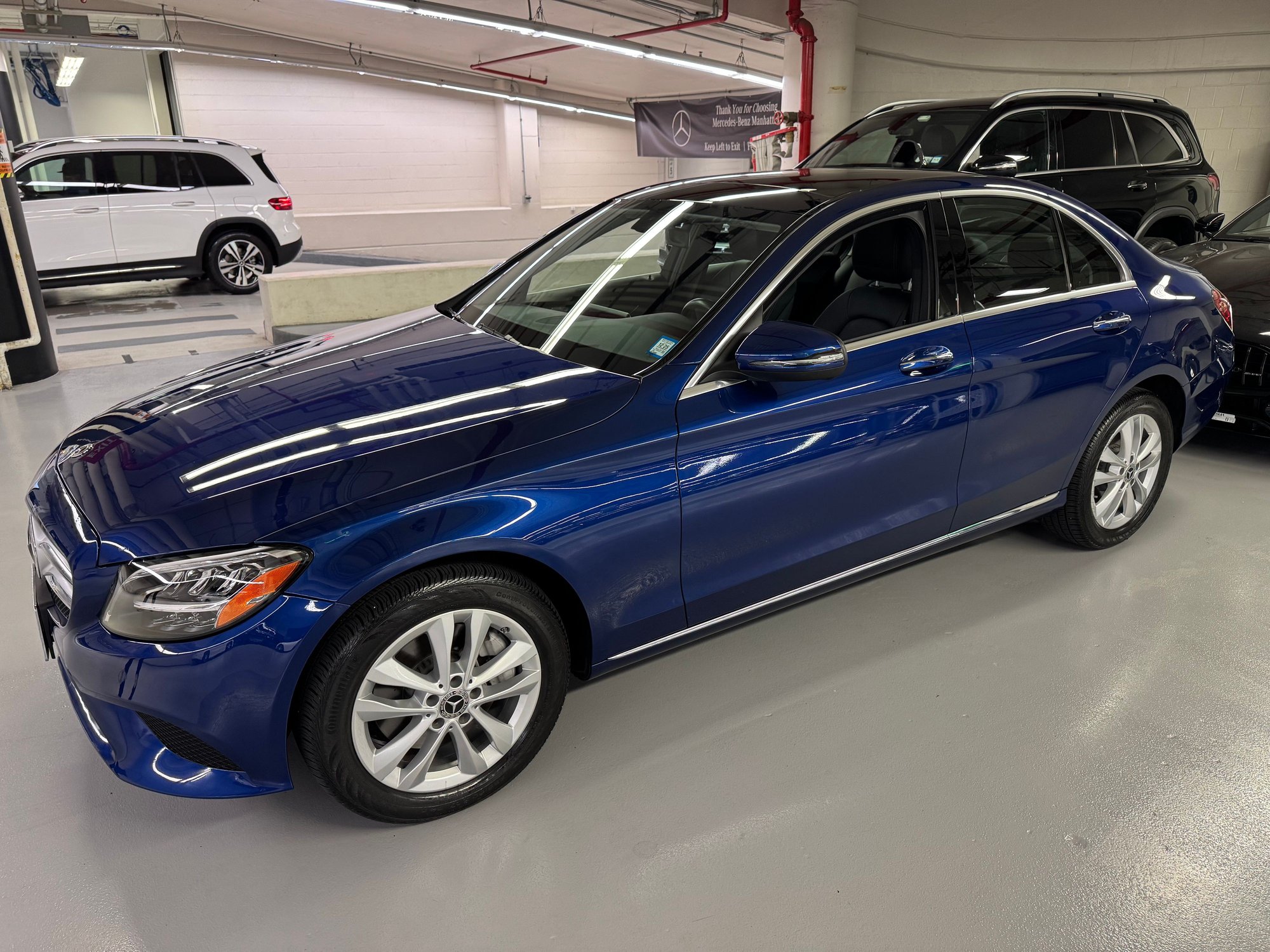

Question Run flats vs regular tires - advice/opinions?
Hello!
I just picked up my new (to me) 2021 C300 last week. I noticed that the ride was a bit on the harsh side and I was somewhat disappointed as I had expected a Mercedes to have a more refined/luxurious feel on the road. Then I discovered that the car came equipped with run flat tires (I discovered this when I asked the sales rep why there was no spare in the trunk). I am considering purchasing regular tires and am wondering if the car's ride would be improved enough to justify the expense. Does anyone have experience and/or opinions on this?
