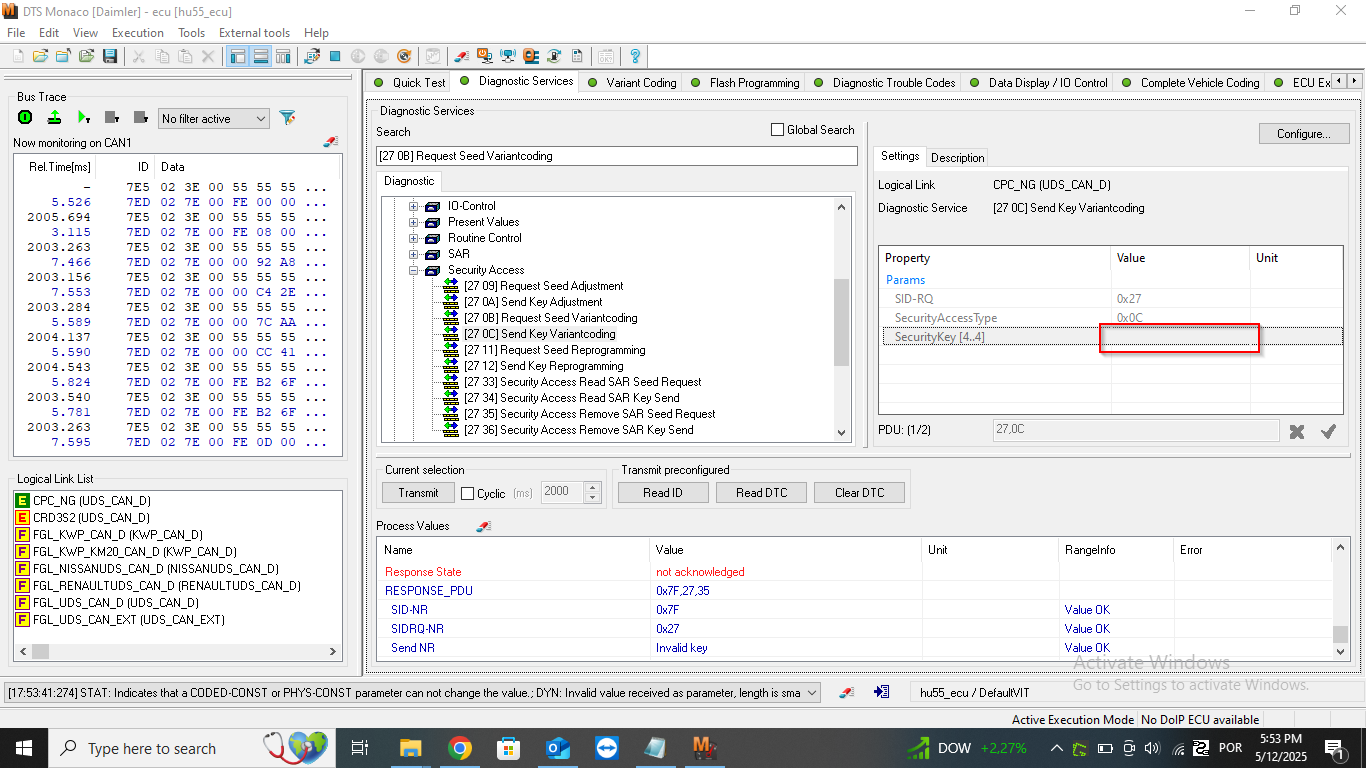

let me take a screen shot 5 min

Old May 12, 2025 | 12:55 PM
GabrielFSousa's Avatar
Joined: Jun 2021
Posts: 75
From: Portugal
c205
Old May 12, 2025 | 12:57 PM

Very good,
Start again from the beginning, disconnect, connect, ignition On, engine stopped....

great thanks to trigital because told me that my car is not cpc_ng, is CEPC .
the process to get the seed is right, but i was using the wrong file ( CPC_NG.SMR-D ).
