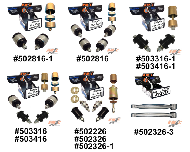

Problem is today's vehicles even AMG Performance models the often quoted re assuring “Full Front & Rear ‘4’ Wheel Alignment” - is now only basic Toe “directional” adjustment.
That’s right - New Car Industry’s Best Kept Secret. All to do with cost cutting and ever increasing speed of new car assembly lines !
Front Camber and Caster along with Rear Camber has been deleted. Stopping to adjust, set is no longer an option.
Yet ability to adjust tire contact angles is essential - to counter excess edge wear. Allowing to spread load more evenly to prevent costly, premature tire replacement. Excess edge load can also lead to ruptured side walls and subsequent rim damage.
Day to day commuting and encountering excess passenger side edge wear through high cambered roads. Or excess inner edge tire wear both sides through altered height, extra passenger loads. While spirited driving and excess outer edge wear. With no longer ongoing adjustment for curb knock damage.
WE SAW THE NEED THEREFORE TO REINSTATE “FRONT AND REAR” ADJUSTMENT / TO FIX IT RIGHT THE 1ST. TIME.
BOLT-ON KITS - Specially designed so no special tools required or need for control arm removal to install.
Along with the unique K-MAC patented design allowing “precise single wrench” adjustment. Easily accessible and Ultimate adjustment - Direct on alignment rack UNDER LOAD.
SEE SPOILER - ALL W205 Models C180-450 incl. C43 AMG 4MATIC, C63/S - Sedan, Wagon, Coupe.
