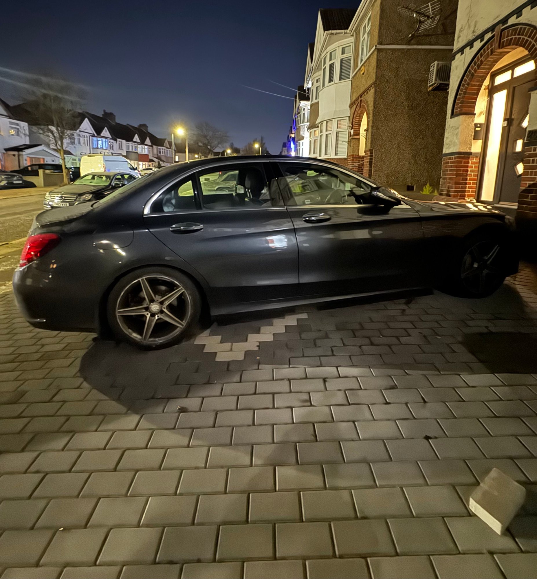

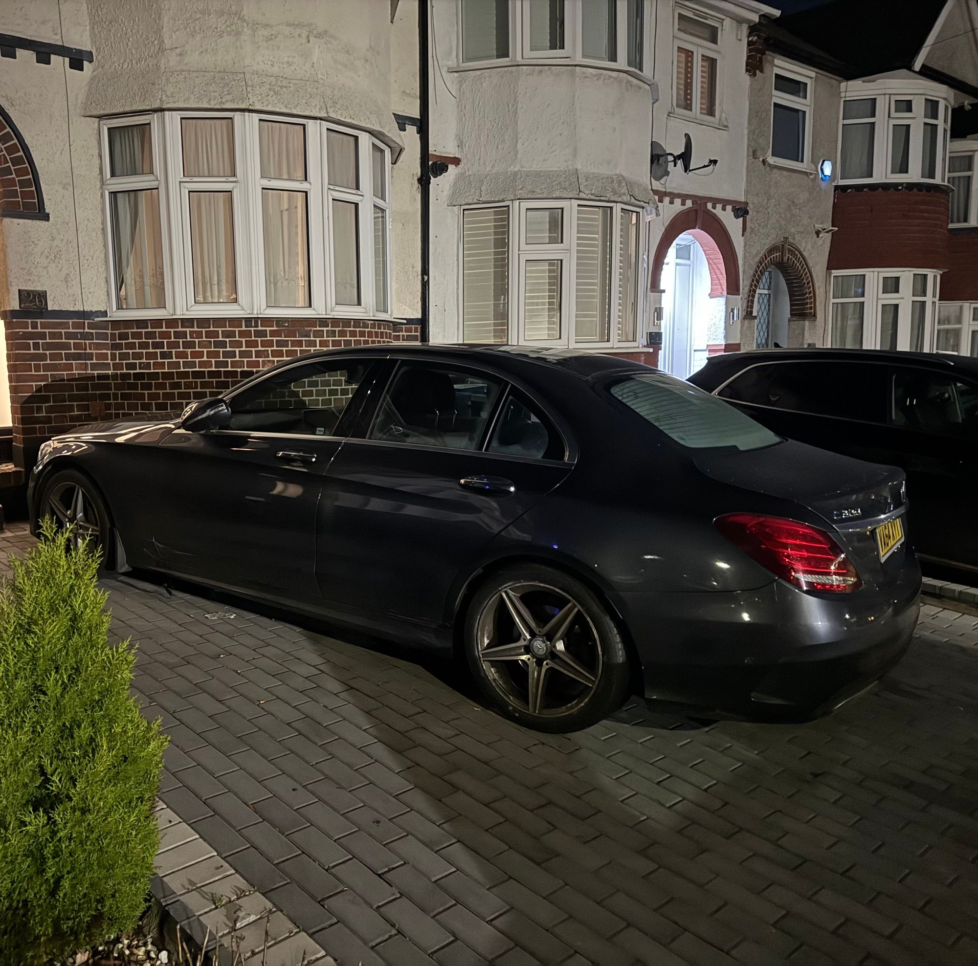

  • My driveway is on a slight incline and I have lifted the car from the front on two axle stands, with the nose facing uphill. It sounds like this would be a significant problem for not only draining all the fluid out, but also filling it up correctly?
    • Would you have any recommendations for making this level? I am wary of putting two additional jack stands at the rear as they would have to be placed on a relatively steep portion of the driveway and therefore wouldn't be safe.
    • Would measuring the amount of fluid that I drain and subsequently filling with that exact amount combat this problem?
Just have a level to confirm level of the vehicle. Pretty simple, or just get a shop to carry out this procedure.
