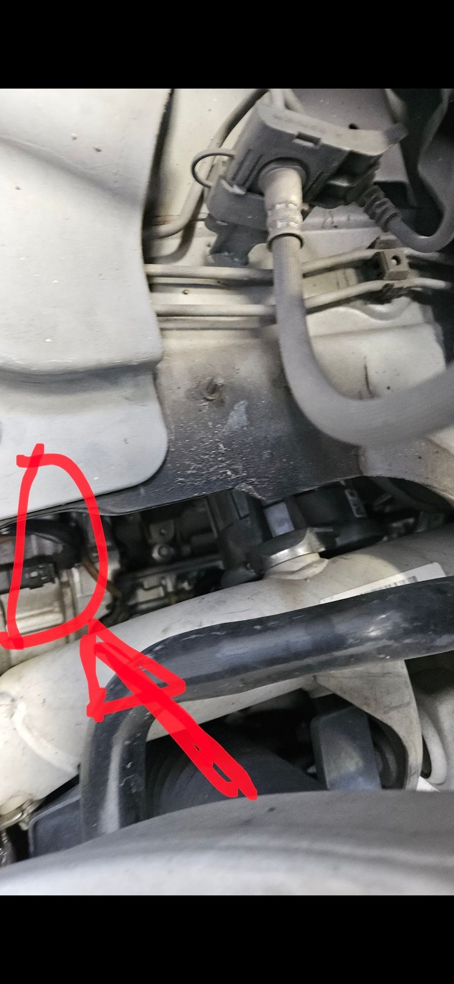

There is something else very easy you can do in that department : waterproof the connections to your A/C compressor.
You can see compressor from the wheel well where it gets sprayed with road elements - The two connectors are not waterproof - Apply engine RTV where wire harness enter the back of each plastic connector.

Revisit this thread next time your compressor harness quits again
Exposed A/C connection
Wheel well view of exposed A/C connections
This electrical failure is not as random as my thoughts.

Do you have any harness run in your front or rear bumpers covers (radar sensors)?
These use connectors directly exposed to road spray.
Each individual wires act as a guide to channel water inside the connector onto the tinny oxidized pins. This guarantees poor connections.
I seal the external junction of wire to connector.
Whatever seals the water out...
