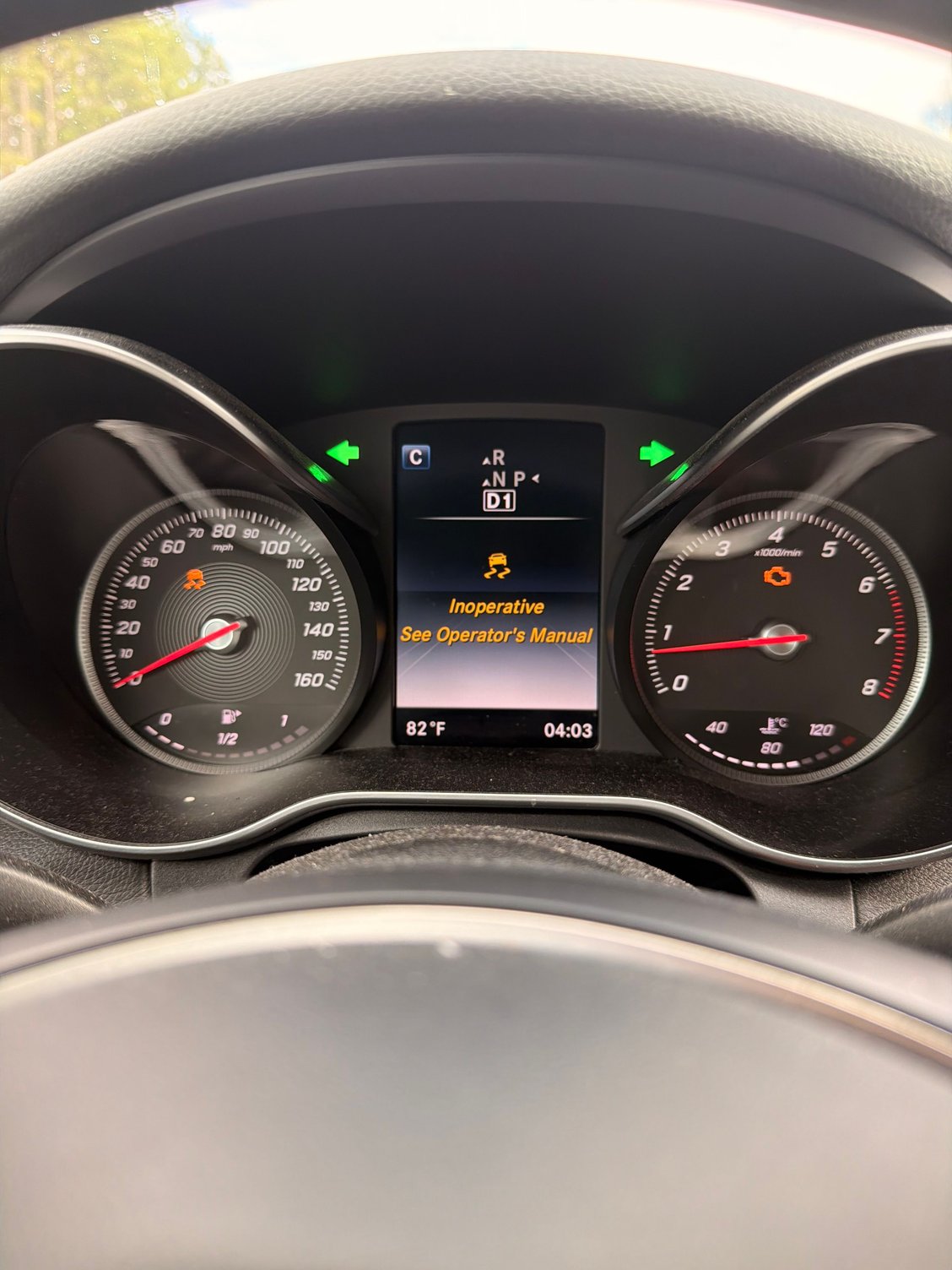

hello, long time owner of c300. Enjoying this car but this this error came few times and vehicle was running fine. Similar error came 3 months back and changing battery fixed it. But it came arain now. Few days back it stopped in the middle of traffic and started moving slowly. towed to local mechanic. Mechanic kept it for 2 -3 days and he says the error disappeared now and it is driving as usual and he cannot do anything else and asked me to take car. I am worried whether anything fixed automatically or the issue still there.
anyone faced similar problem? Any permanent fix? I don’t want my wife or daughter who uses them regularly stranded in the middle of the road.

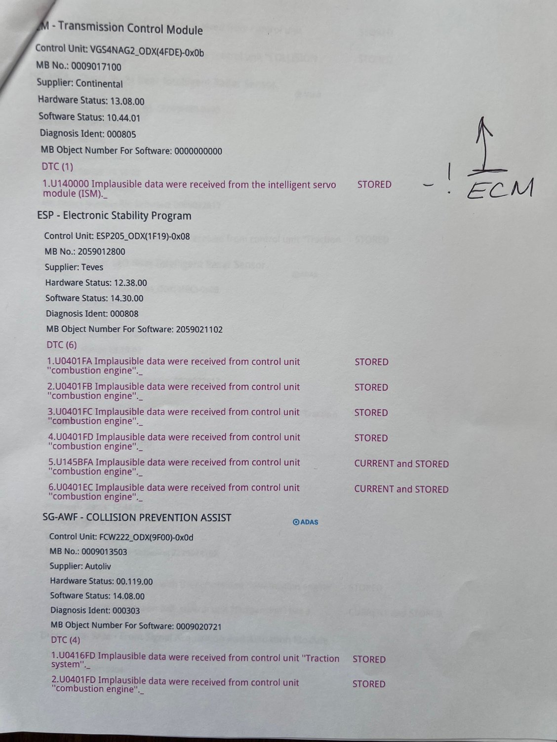

Diagnostic report
Attached are the diagnostic report. Technician says drive for another few days bring it back to check again. But he tells it’s a mystery.
any help and guidance is much appreciated.

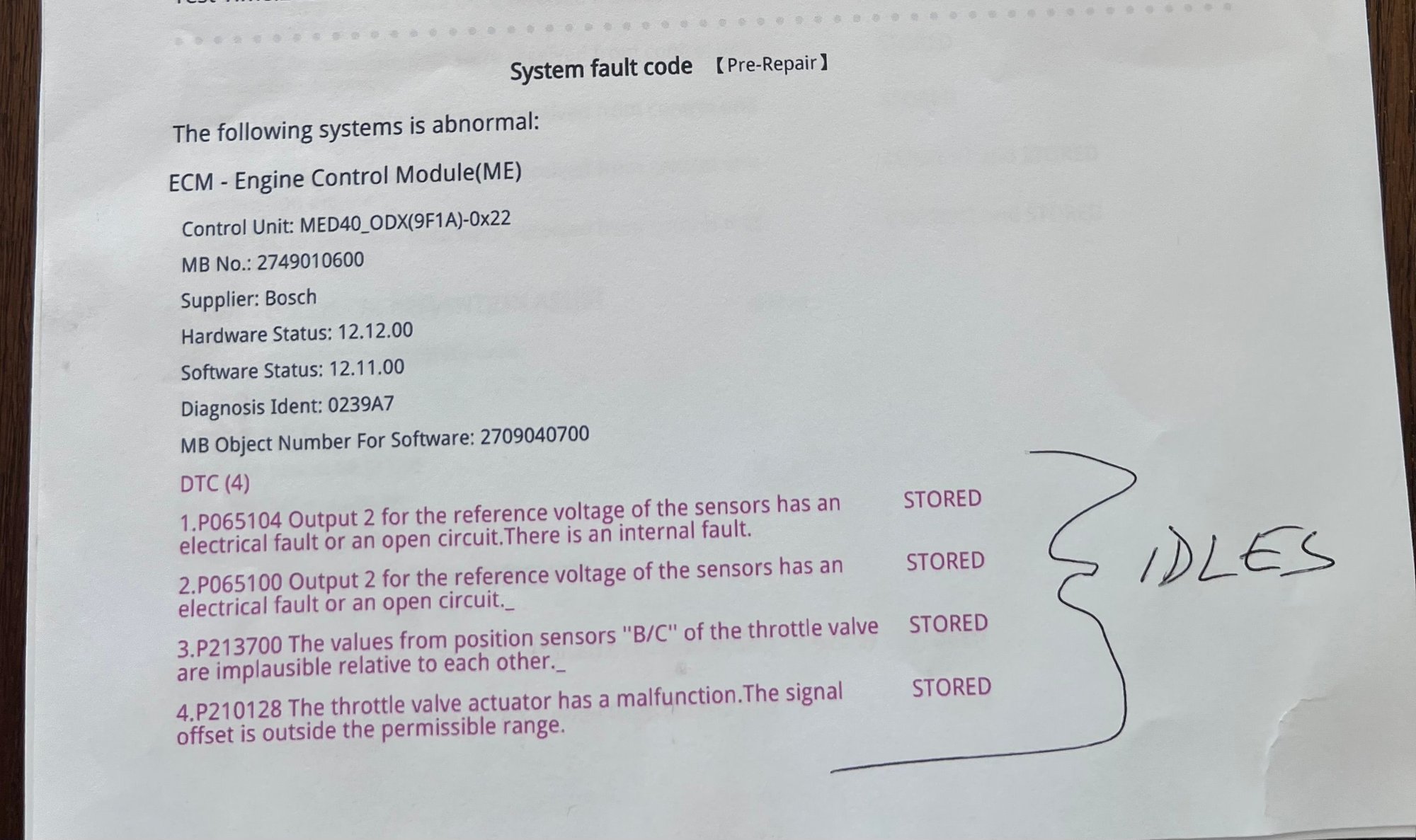

I'd focus on the throttle valve actuator and the first group of 4. I assume your mechanic cleared the codes so that the problem will re-trigger the faults when they occur (?). Did he do any further diagnostics on the throttle valve?
yes. He cleared the codes and asked me to come back. He kept saying it could be idles problem. Is it related to the throttle valve actuator?
the mechanic seems to have experience with the European cars. He explained that it could be one of the electronics components but checking each one is not practically possible.
what I don’t understand is if the warning comes back again what are the chances are it tells the right code? That is what he is expecting I think.
regarding throttle valve actuator is it something DIY? I fed the report to Gemini and it spit out some options. I can do DIY to some extent. But not much on the cars.

Consider the meaning of the entire fault collection...both stored and current.
What stands out is the ECU being at the heart of this mess restricted on CAN-C only!
ISM + ESP are only on the receiving end.
this TRANSIENT acted as the root for this
this TRANSIENT acted as the root for this em'cy
This is a voltage transient that freaked out the ECU throttle circuit watchdogs. That is usually either a poor battery voltage or painted "GND post" circuits.
> Practical DIY Suggestions...
  1. Clean ECU GND circuits sources!
  2. Don't let batteries drain (use a CTEK float)
  3. Defective throttle sensor (recalled TSB)
  4. (ECU capacitor may be marginal)
Let's see where this repair goes...
