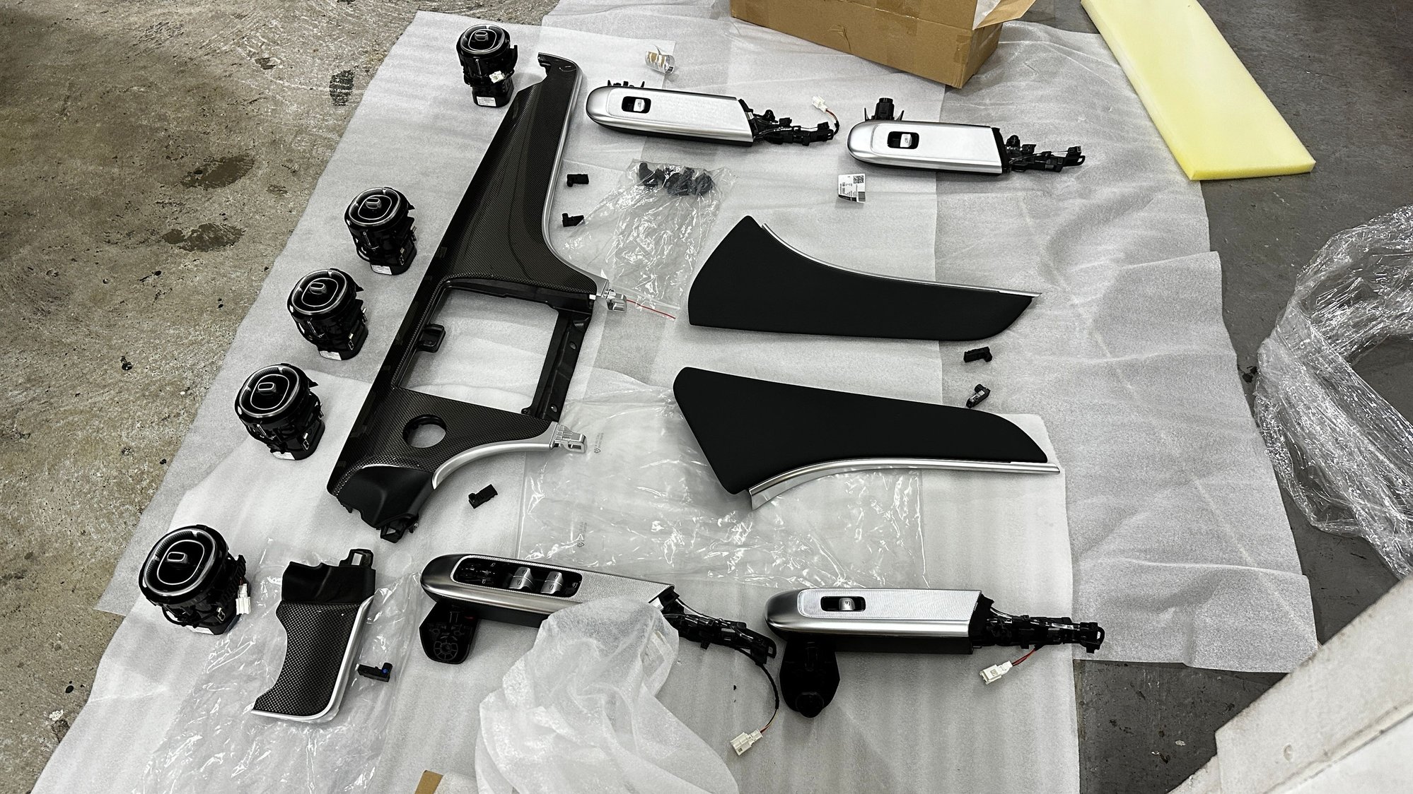

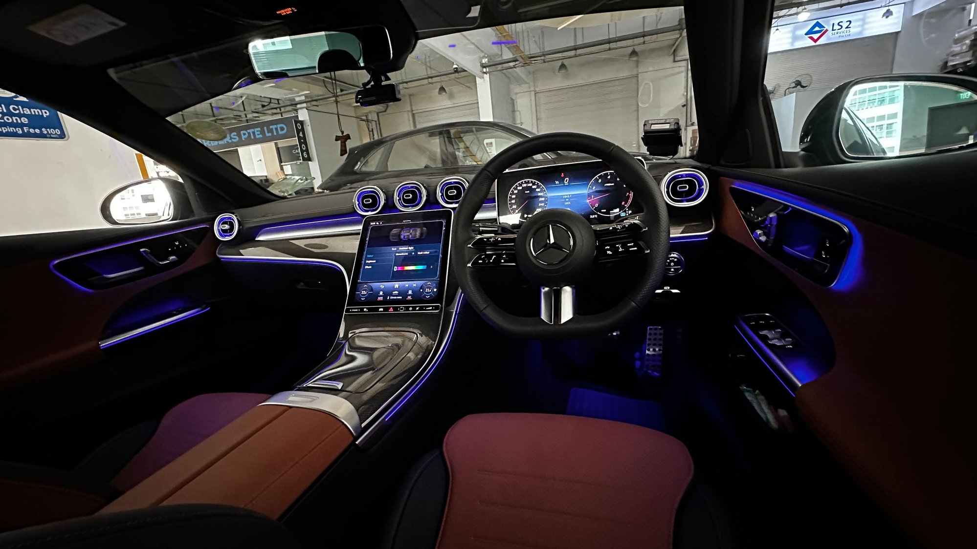

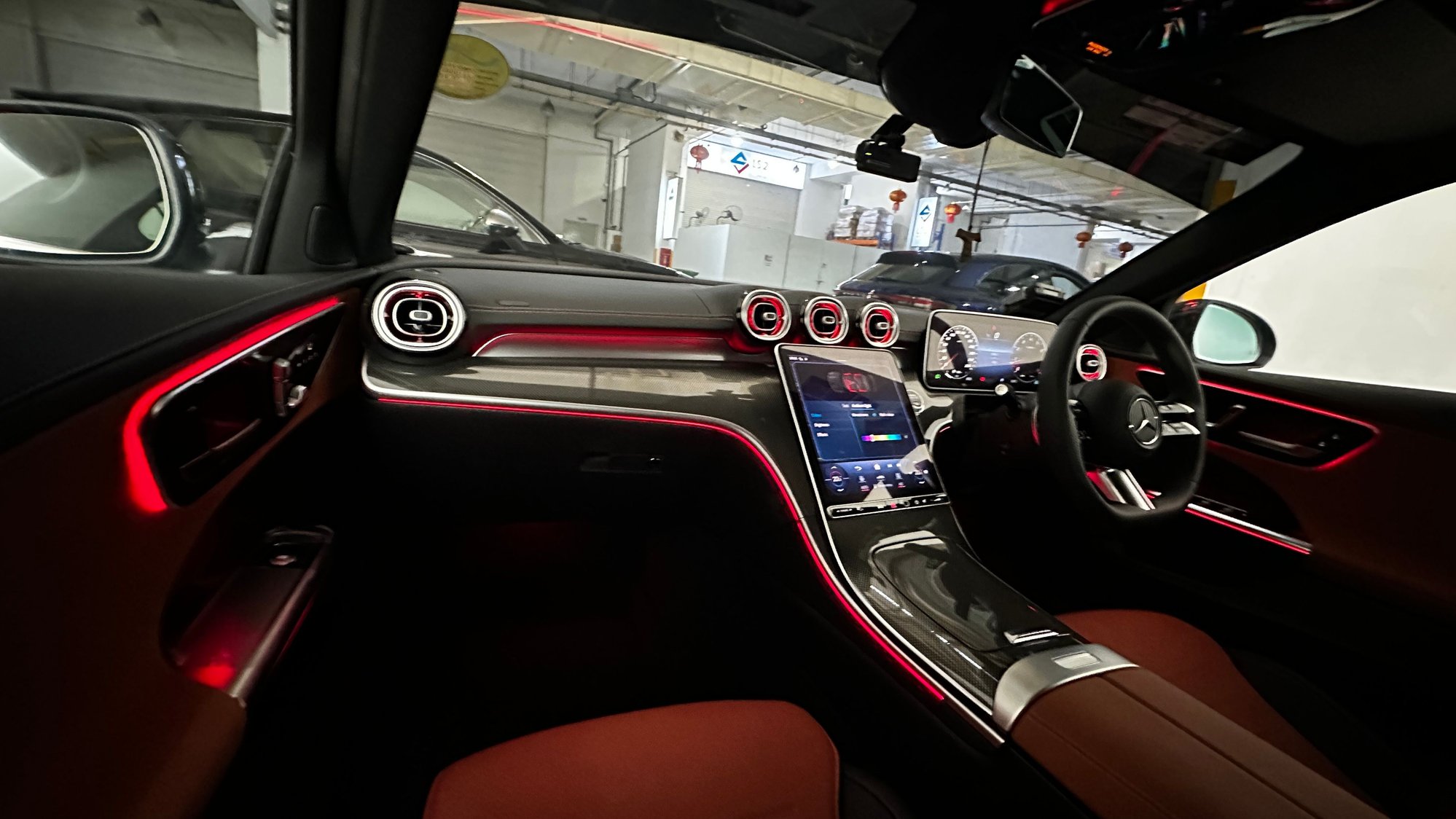

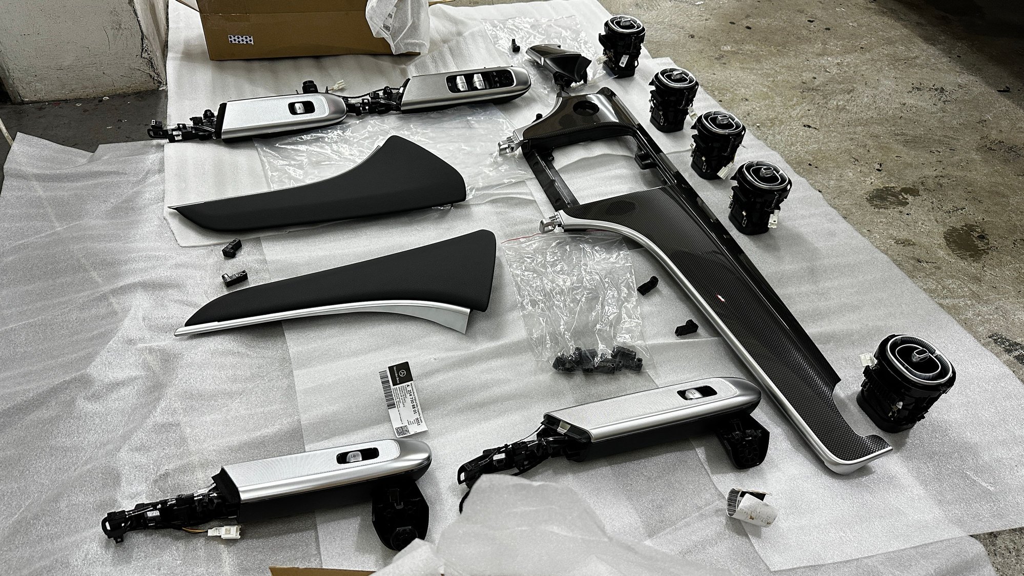

Today we are retrofit SA894 Premium Plus Ambient Illumination aka Enhanced ambient light for one C180 W206, 2024, RHD
This car comes with SA891, Premium Ambient Illumination (22 Lights in total), Customer not happy with this SA891, so he decided to upgrade to SA894 Premium Plus Ambient Illumination (extra 24 lights, means 46 lights in total).

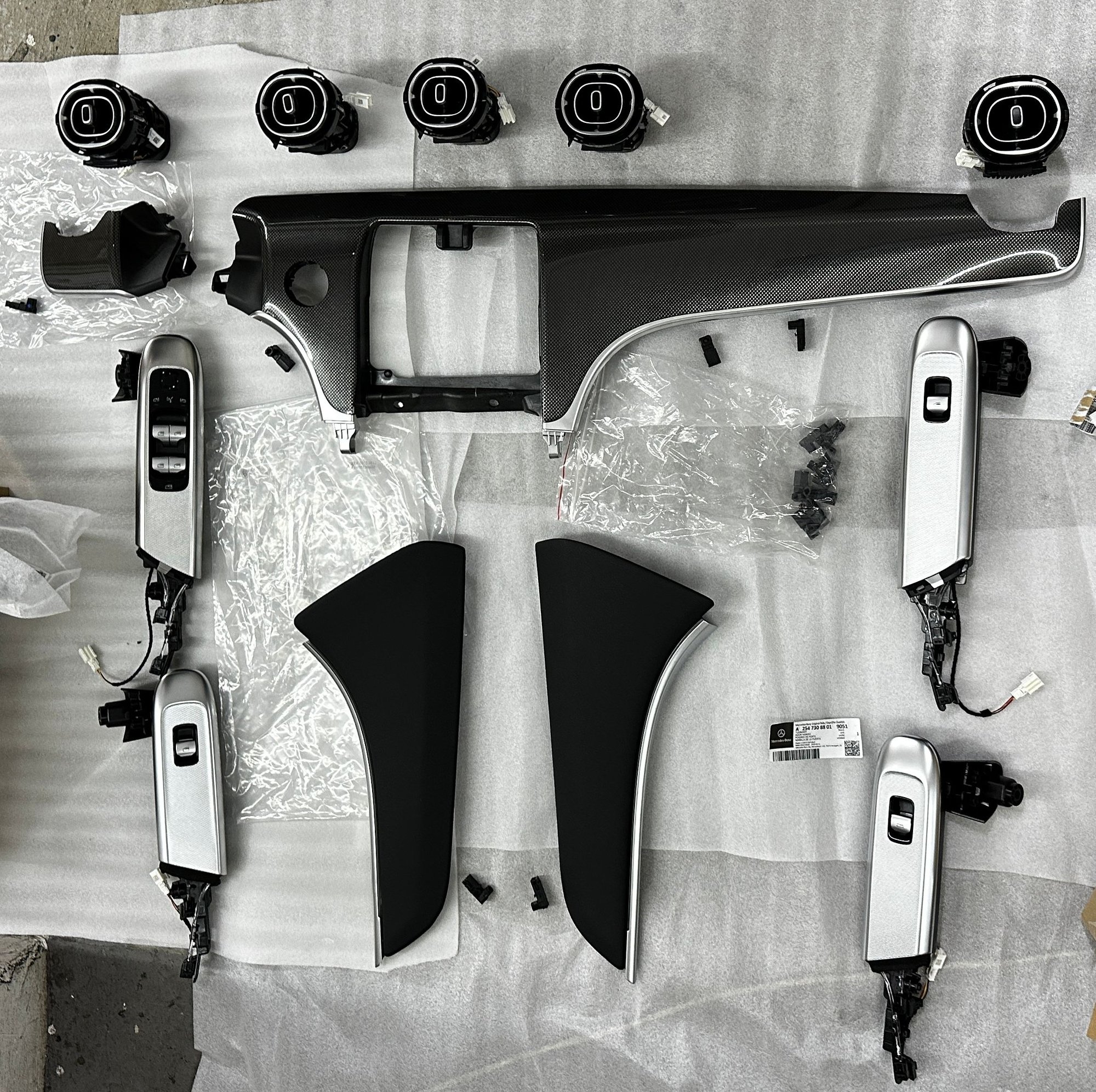

Here you go, we are doing one car now, pure original upgrade, you will get extra 24 lights
5 AC vents, 10 lights
Dash panel big, 3 light, Dash panel small: 1 light
Center Console panel left and right: 2 lights
Door handle x 4: 8 lights

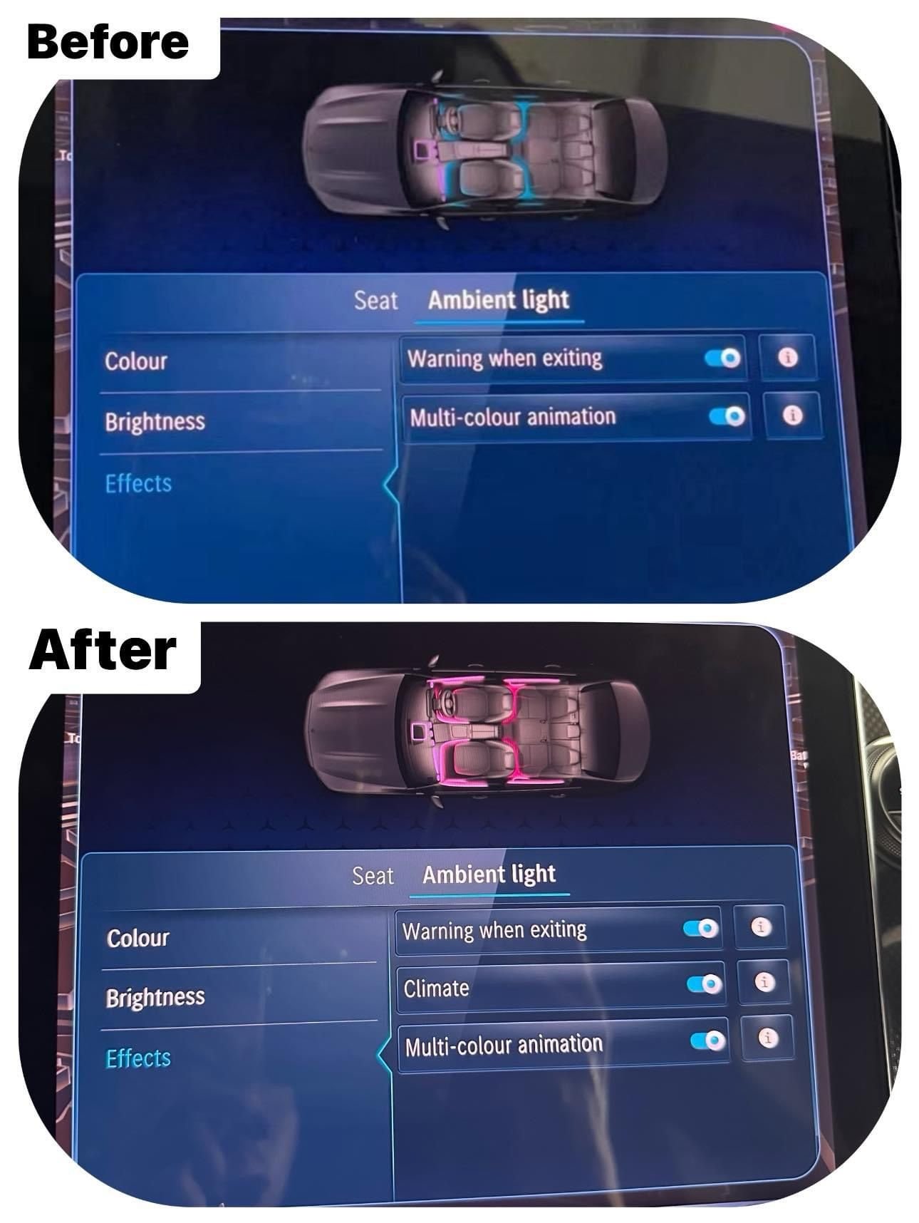

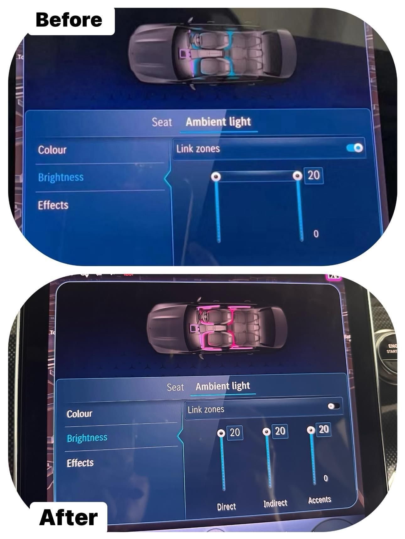

In ambient light menu: you will get 12 multicolour combinations (from 10 *), you will have 3-zone brightness control (from 2-zone), you will get extra climate effect (red/blue ambient light when increase/decrease AC temperature).

Originally Posted by BigDeeLA
Was this retrofit for the 2023 GLC or the 2024 GLC?
and does it matter if it’s the regular or coupe?
And how would someone in the US get this done? Would you guys sell the parts?
2023 or 2024 shares same parts and wiring and coding.
The reason why people differentiate 2023 or 2024, it is because they are installing non-Original AC Vents because the tapping point at footwell has different connector. But if you install original kit like I post, 2023 or 2024 are same, as we strictly follow original wiring, no need tap wire on footwell.
COUPE or SUV shares same parts and wiring and coding.
C class or GLC use different hardware, size or shape slightly different.

GLC X254 C254 PPAL Retrofit Kit 001
GLC X254 C254 PPAL Retrofit Kit 002
GLC X254 C254 PPAL Retrofit Kit 003

How did you connect the original airvents to dashboard harness?
Old Mar 28, 2024 | 10:06 PM
No need to do so. Check my video above.
Great. Did you make that cable yourself ? Is it possible to buy it?
yes. Home made, you can buy those parts from your dealer and buy cable from us.

How to install PPAL SA894 in your C or GLC
Check the video above for how to install the original SA894 PPAL hardware.
For software codings: Feel free to contact us or your preferred coders or local dealers.

Originally Posted by SUSO4
Need software coding?, why?
usually original parts need coding after hardware are installed.
you saw the video you got one extra Effect and one extra zone control in the ambient light settings? That is result of coding.
