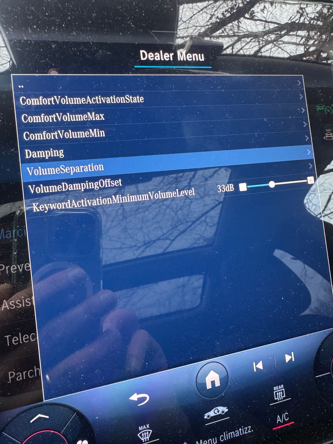

Please somebody help. I need to start music with low volume but i cannot find a clue with dealer menu.
I try to lower the slide KeywordActivationMinimumLevel but seems to not work:
And, somebody knows what all those function needed for ?
Thanks for your help

Keyword activation might be mercedes assistant volume
Old Feb 11, 2025 | 09:39 AM
W205C43PFL's Avatar
Posts: 32,217
Likes: 6,275
Comfort volume might indeed be what you are looking for but I am not fully sure https://mbworld.org/forums/gls-class...-settings.html

I'm not familiar with the dealer menu, but KeywordActivationMinimumLevel from the name is not what you are looking for. That controls how loud you have to speak when saying "Hey Mercedes" before it reacts to the keyword. The music starts at the volume level you left it last time. Not sure if that can be changed and to always have it start at a specific level, but none of those options look like what you are looking for. Also if this is possible, it may have to be coded using Xentry and not via dealer menu.

KeywordActivationMinimumVolumeLevel controls how quietly you can say "Hey Mercedes" or "Mercedes" for the voice assistant to activate. The lower the dB, the more quietly you can say it to trigger.
I believe for your needs, I would adjust ComfortVolumeMax > Entertainment and raise it around 5dB. You can also adjust ComfortVolumeMin > Entertainment as well, however, raising the minimum level will narrow the spectrum of volume available making your volume slider less sensitive. You can lower the ComfortVolumeMin, however this will make the lowest volume setting even quieter.

What i need is everytime i turn on the vehicle, have the volume in a certain position, not to much loud because with new amplifier volume is to loud at the beginning

The last selected volume always saves in both my 22 and 23 w206. Some mornings I am jolted since I set the volume so loud the night before. I suspect this issue is tired to your new amp.

Thanks, it's clear now. Happened to me as well.
Acting in ComfortVolumeMin help this issue, i can fade better on the first part of the volume slider.
