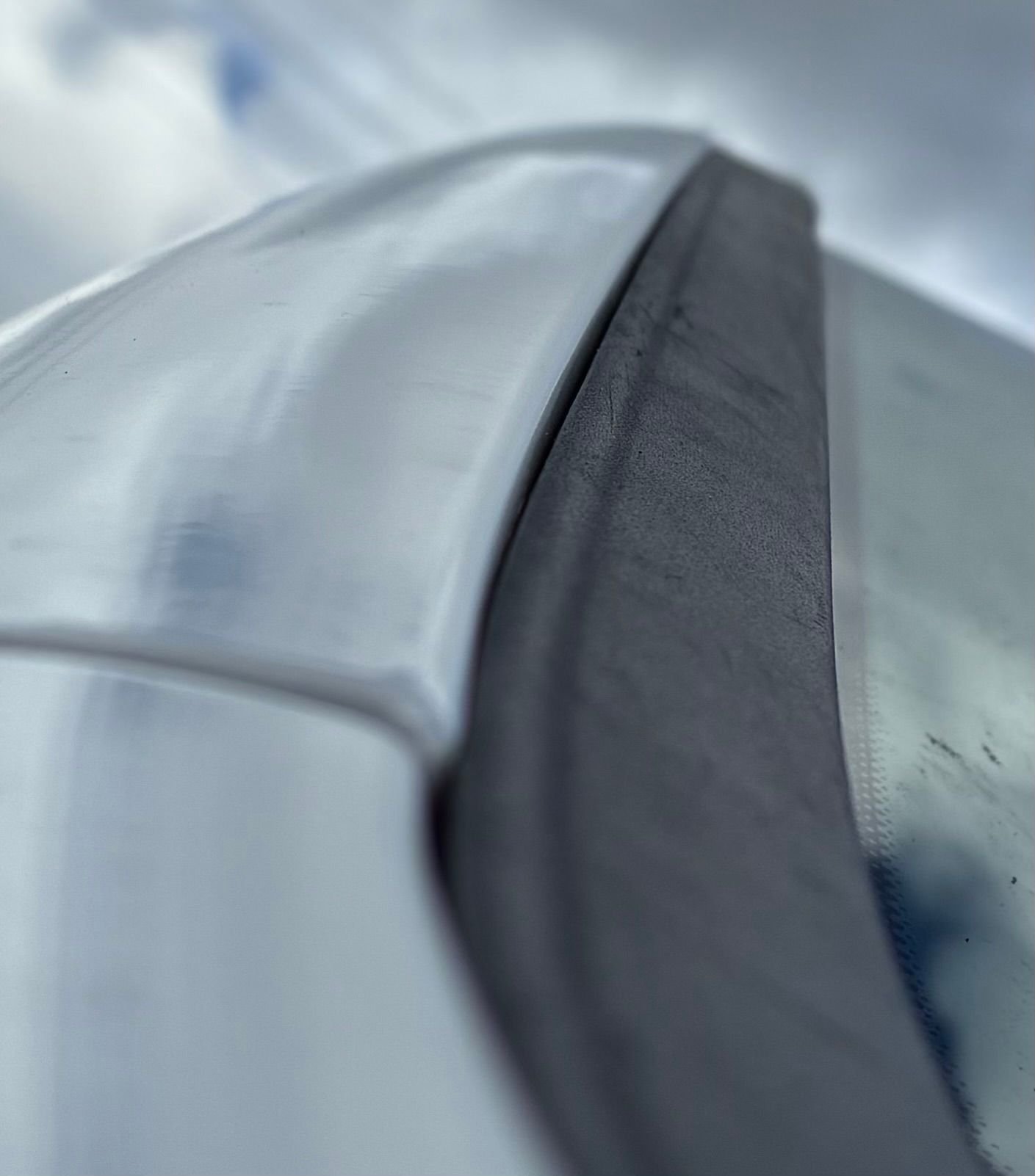

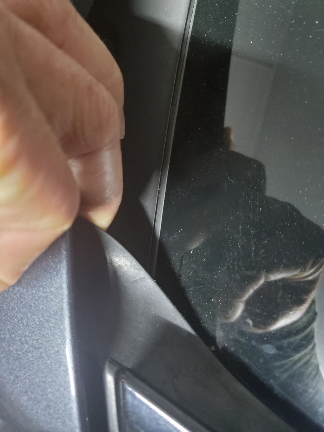

Mar 17, 2025 | 07:27 AM
I have had that twice on MB cars. In each instance it was at the bottom of the side trim where a small piece of rubber is out of the metal shield thing near the wiper blades. On one car I replaced it, the other I used some clear glue to hold down the "flappy" piece....I can get pictures in a few minutes.

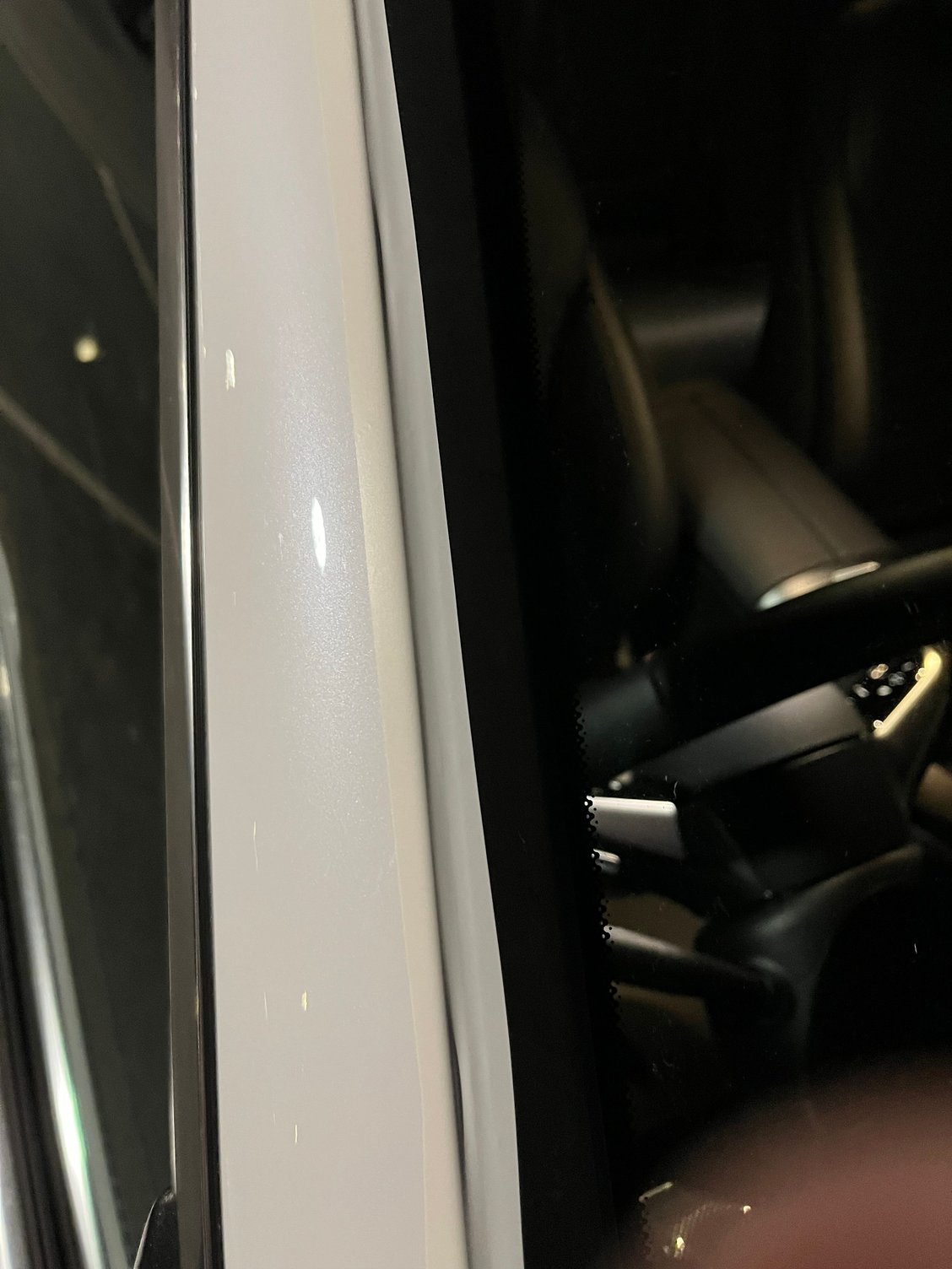

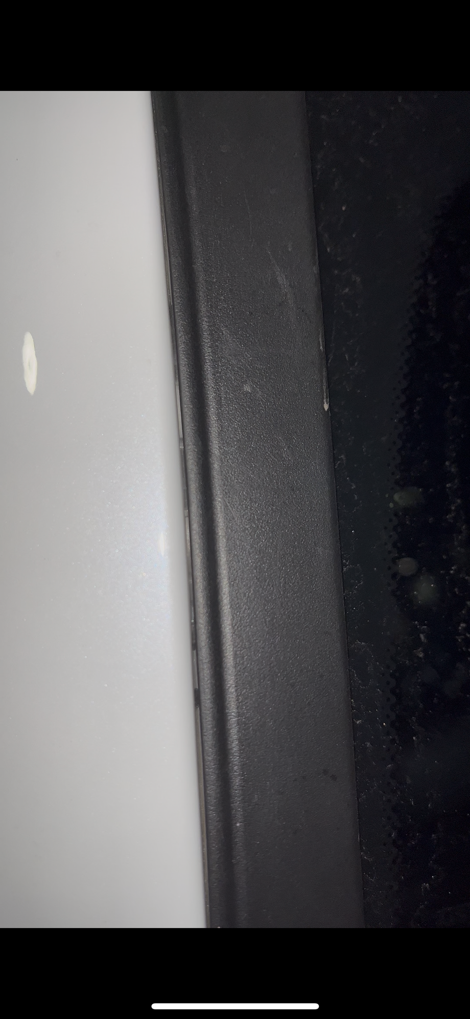

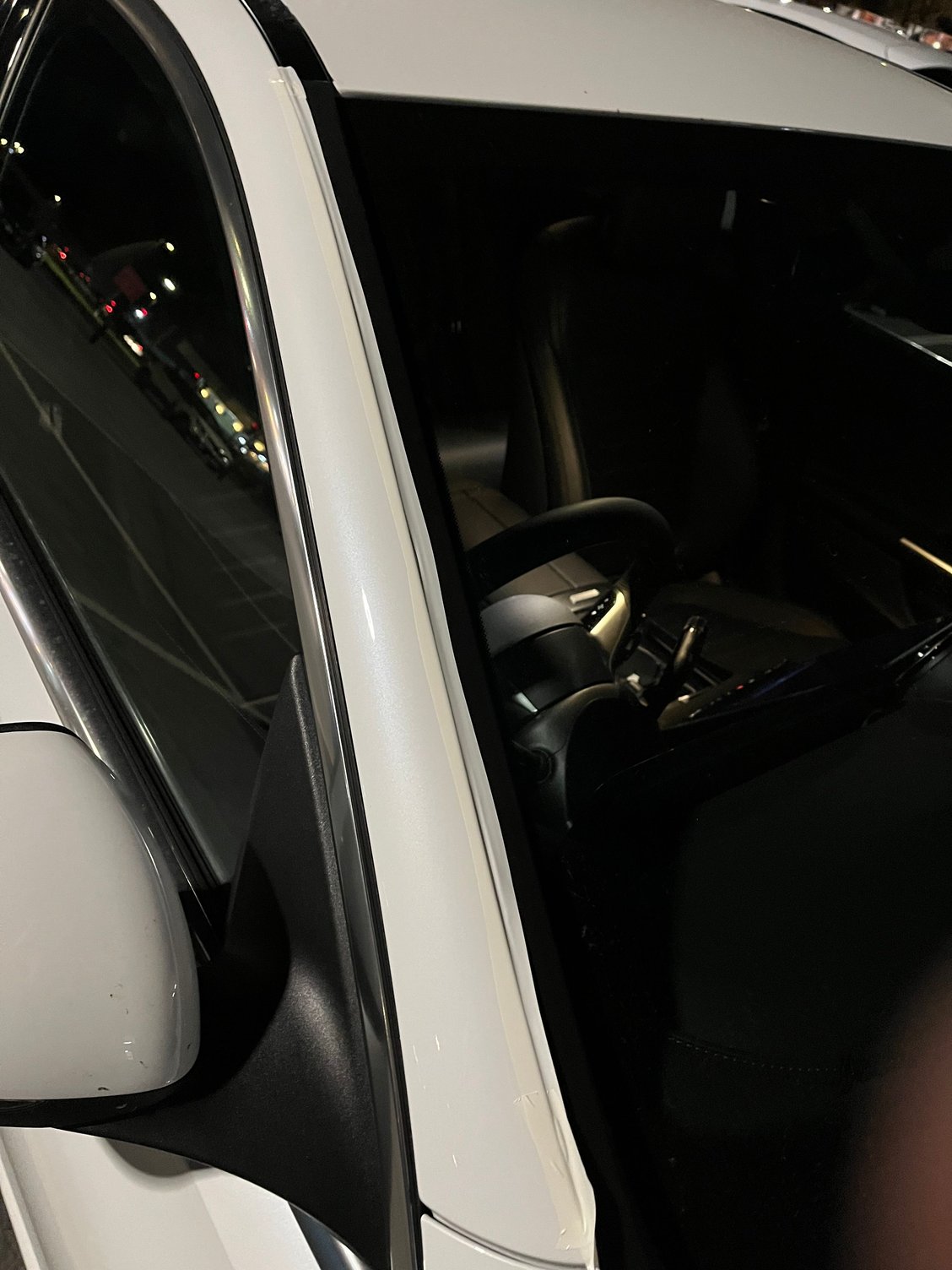

Hi all,
Sorry for the delay in replying. Thanks for all the ideas.
After a bit of scratching my head and taping up certain areas one at a time.
I’ve finally managed to locate the whistle to the right hand side water deflector trim on the windscreen where it meets the A-Pillar.
there are two small gaps 1-2mm where the trim is not sitting flush against the A-Pillar. I didn’t notice it at first because the gaps are that small. It’s only when I taped it up and the noise stopped. On closer inspection that’s when I found the gaps.
its very strange as the left hand side sits flush.
either the trim isn’t manufactured correctly or the actual a-pillar isn’t? The are metal clips riveted into the A-pillar that might also be out of spec as the trim clips into them.
