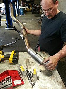

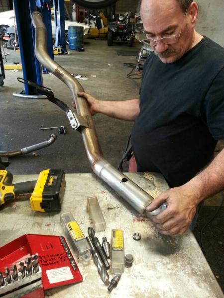

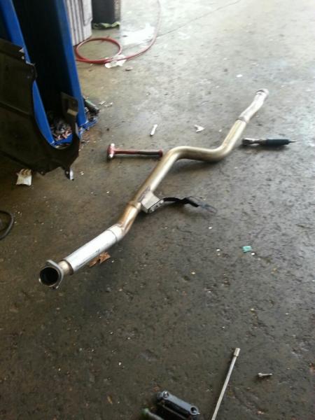

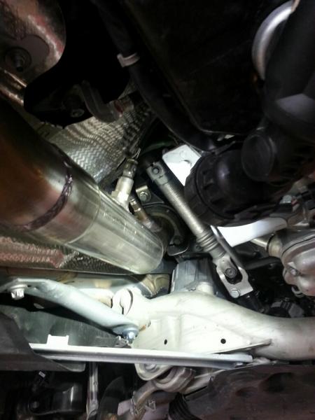

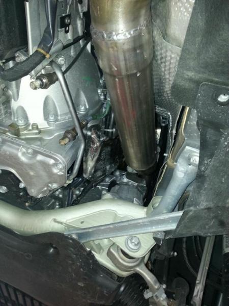

MY CUSTOM DOWNPIPES WITH PICS !!
THEY DEFINITELY MAKE MORE POWER WILL HIT TRACK AND DYNO BY WEEK END !! THEY SOUND AMAZING AND PUTTING THE O2'S BACK IN THE SAME PLACE HELP KEEP ECU HAPPY ... ALL 2.75 FRONT TO BACK !

i believe they are catless? and where did you get it done?

If you are catless, you will need a tune to avoid CEL.

i used alot of the stock pipe its almost 2.75 anyway like 2.71 to be exact . my buddy is an adrl px racer and fab'r so we used his shop . the only restriction i seen in the factory exhaust is the flanges at the manifold so that explains the increase in power changing that **** for 8500.00-12000.00 ...hell i think you could pick up alot more at that point and not even doin turbos but hey what do i know im new with this car . ill get some sound clips shortly but i really think serge is right 2.75 make more power than the 3 inch after what i saw during install and im willing to prove it same day on dyno swapping to 3 inch !!!
