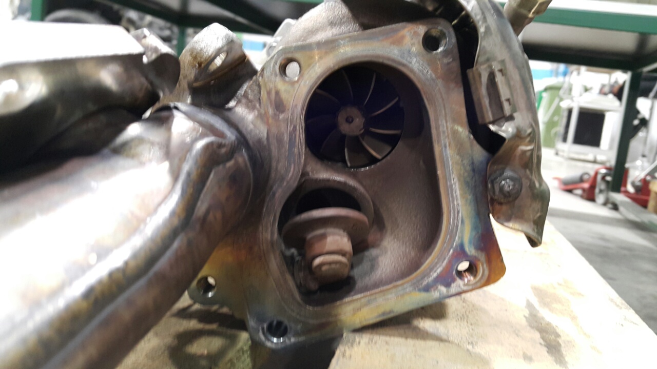

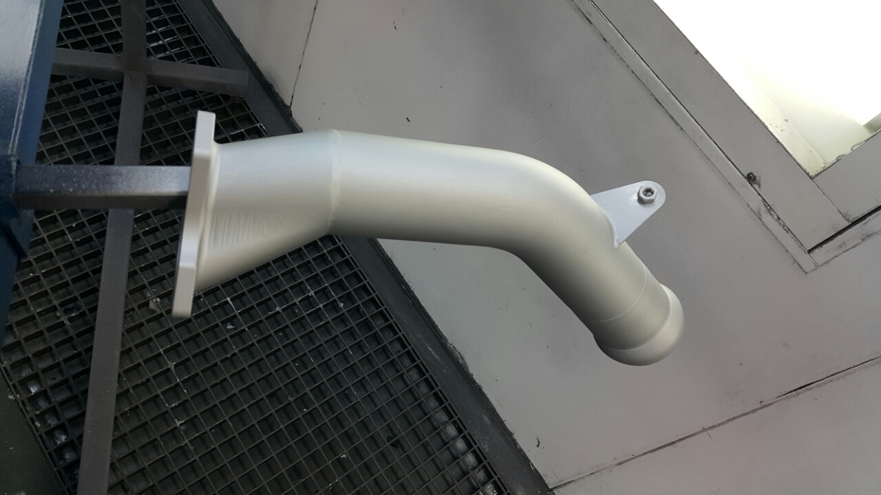

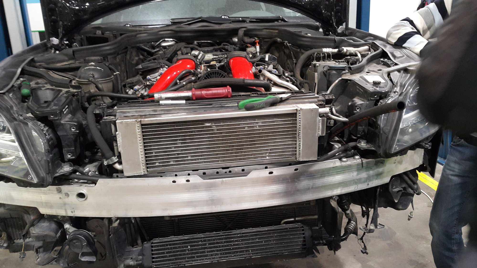

Let's see the outcome. I have installed turbos today. I will send 2 ECUs to Kleemann. One for 98-100 octane fuel and another one for 110 octane fuel.
Attached Thumbnails Kleemann Turbos ARRIVED!!!-0288f3bca55491cda959afc9631756c18b8abdb3865c78b699c2578e176b80d7.jpg   Kleemann Turbos ARRIVED!!!-465fc73a2587f3e72b32f9a7930fbdb8e166bfc0db3144f6de74bf8e4f6ad02b.jpg   Kleemann Turbos ARRIVED!!!-837fe808545f3459efe488f89d89f1f3e3d4b78c7d6a3a8256467a5e647765d1.jpg   Kleemann Turbos ARRIVED!!!-a84043c45ab3672055706f305035863528b759974fa745569d8dfd96b9862bc4.jpg   Kleemann Turbos ARRIVED!!!-11115990_10100230015426050_758283448_n.jpg

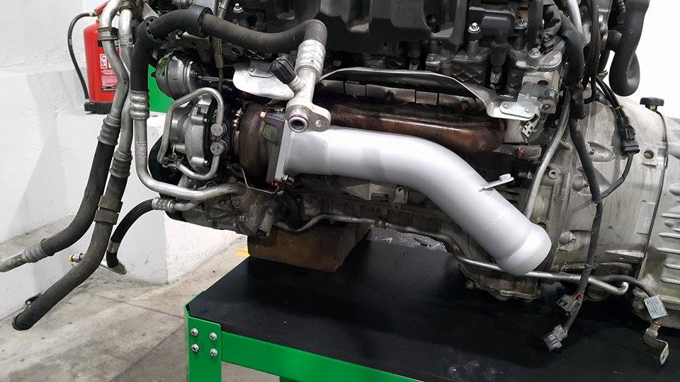

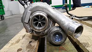

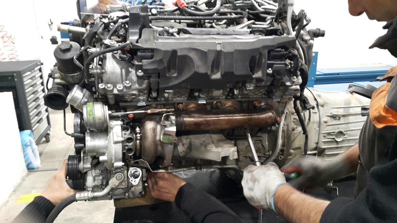

Here are some pictures of the installation process
Additional Heat Exchanger

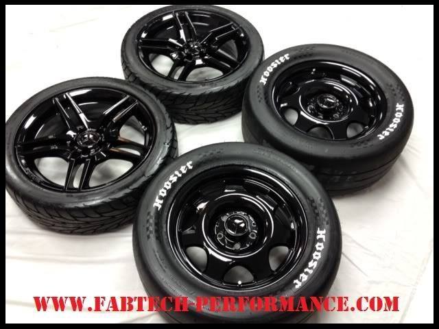

I have installed Qualife LSD to solve the problem with traction. However that is not enough. I have a set of 18' Hoosier DRs with lightweight Momo rims and that is what you need to maintain control over the traction. I also working on 16' Hoosier DRs with super light weight CLK rims. In this case there is a problem with sixe of rear brake disk. I might swap the rear brake disk with W212 e350 brake disk. I will trying to figure out which size of brake disk is small enough to fit the16' rims.
I have increased an inline pressure of TCU that helps to prevent slipage between the frictions in the gearbox for cars with massive torque.
Old Apr 17, 2015 | 12:52 AM
Goletiani's Avatar
Joined: Jun 2008
Posts: 180
Likes: 12
From: Tbilisi, Georgia
2012 CLS63AMG Kleemann K3
Here are some pics of 16 inch CLK rims. I did black coating to make it look better with black car
This is the setup I am going for!
This is what I currently use for racing!
