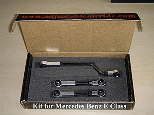

I used the links and they work just fine.. especially for $240 shipped compared to the more expensive systems.. You can easily adjust them in minutes or just put the OEM ones back on if need be..

How low did those links get you, Is your car slammed or still an inch up. Can u post pics of the old links so we could compare the difference.

Those links are threaded. So you can adjust the threads and the ride height is fully adjustable.
However, I'd go for Renntech ELM, which would actually raise the car back to the correct height if I go faster than 80mph+ The last thing I want is my car bottoms out at 80+mph
