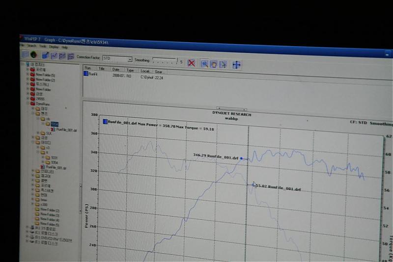

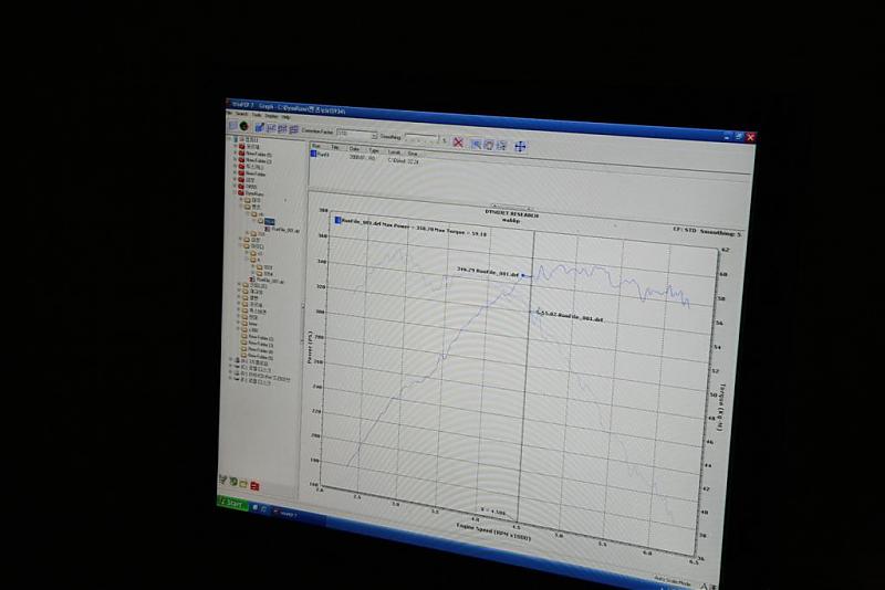

sorry to keep coming back to this but it's a major issue and hope that some of you can shed some light on this. i took my car to get it dyno'ed on Tuesday and surprise surprise it came out like crap. here are some specs on my car:
About my Car
Car: 2006 CLS55 AMG German Edition (bone stock, limiter removed by factory)
mileage: 26k km (18k miles)
No fault codes
checked air filters
About the Dyno

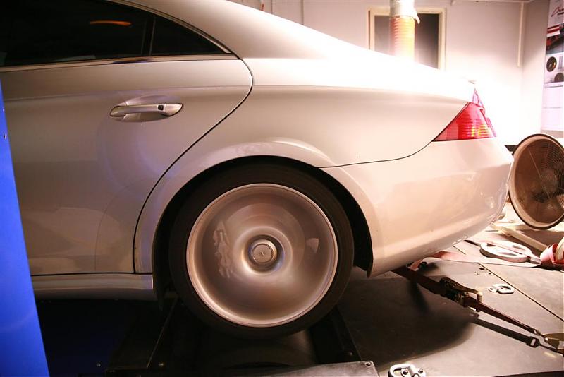

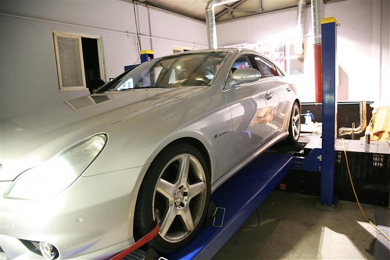

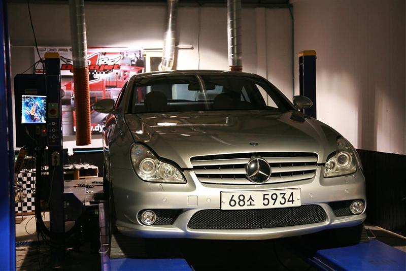

Dyno'ed on a dynojet (as in pic). The dyno has been tested and my friend's slk55 ran a 580rwhp and my sl55 had 435rwhp. so it wasn't the dyno's fault.
Funny thing is that my car has no problem keeping up with my cousin's m5 and my friend's cls63 on hard acceleration or on the highway.
my friend thinks it may be the belt slipping, is this common and if so would my chart look like this?
other mechanic suggests changing the i/c pump. wouldn't a code pop up if this were bad?
someone on the previous post had suggested checking for clogged exhaust. is this even possible and if so how would you check for this? I have the common "roaring" exhaust and it doesn't sound clogged.

Weird...My 63 put down 403, and I think some have put down 420 ish

Something is not right.
Do you have access to OBDII scanner?
Can you datalog the car?

usully first thing that pops to mind is bad pump...but you are an 06 which means u should have the new pump.
Maybe fuel is bad?
did you have the car in dyno mode?
you should be at 390-400rwhp minimum i think
and no you will not get a sign or light if you pump is bad

something is definitely wrong. You should be pushing anywhere from 410-420 hp ish at the wheel...
Definitely get it checked out...
