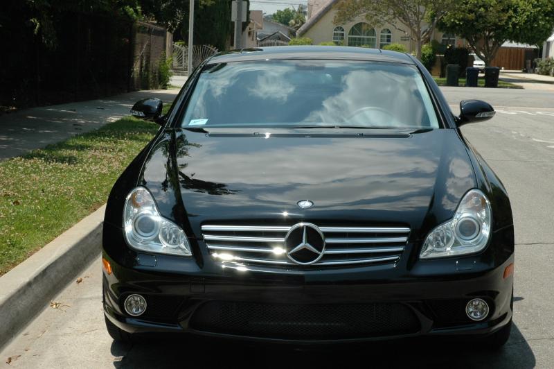

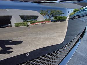

I got 6 holes! Took me an hour and filled them in with bondo then painted with MB touch up paint. Not really noticeable in a black car.
