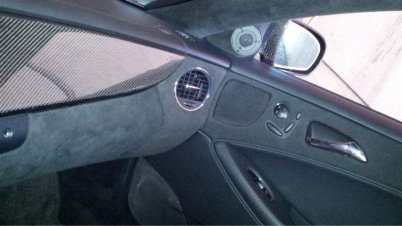

ciao Kelvin,
left door is the same as passngr's
yes, obviously I had to relocate the mirror's controller
it was a very debated issue where to relocate it ..
if you want to know the whole story:
for example this guy put it here, above the armrest, but I did not like that
best would have been to have that controller integrated with the other buttons on the arm-rest, as other Mercedes cars have (C204 and other newer cars) ..
I looked into that possibility but the buttons of our car have a particular shape and would not have been nice..
Maybe the best feasible solution would be to replace our light switch on the dashboard and replace it with one from CLK (or something like that. .. don't remember correctly) who integrates the mirror controller into thelight switch ..
That would have required to mod somehow the dash housing to fit it into.
As I did a lot of work on my dash because my bottom side was upholstered with alcantara , we could have done that mod also ...
unfortunately the idea of using that clk switch ( or G-class and SL-class switches) came late, when the upholsteirng work was already done ..
btw, I also upholstered in Alcantara the back of front seats and the small drawers
considered also the possibility to make an openable device like the rear door ashtray ... but indeed our mirror switch is a really big thing.. and my installer was already tired,
so in the end I found, as a somehow temporary location, the solution to fit it close to the trunk switch, into the door bottom pocket.
Not extremely comfortable but, as I use it so rarely, it is still there

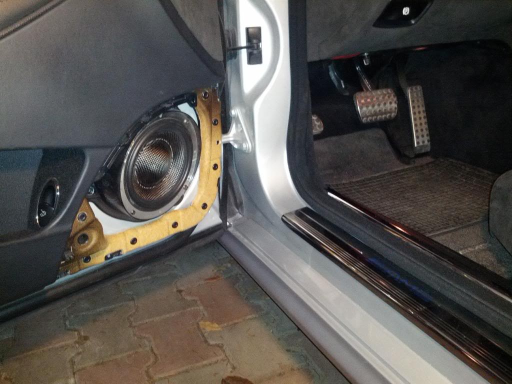

Originally Posted by Kelvin07
I did, very easy install on the front doors, I will take pics so you can see, it looks OEM.
Dyno, when they installed your 4" mid ranges on your door panels, did they have to cut some metal to make the fit?
yes, they did a small cut for hosting a side of the magnet.
btw, I placed the carbon morels on front doors and .. should have put there before ..
lately I am playing with high-def audio in 24bit-96KHz sampling rate and these speakers are really great for playing strong basses.

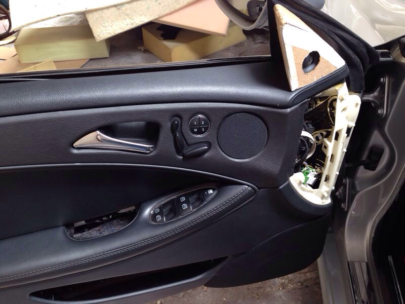

I meant this one... The little speaker. Did they have ti cut the metal behind the door panel to make it behind the grille?

Correction, my installer told me it was a very meticoulius job to make it fit strong and tight.
They are not an audio shop, they are an upholstery shop, they will do the alcanatara on my roof and pillars.
I got it right .
again, yes
your mid bass install seems Ok .
too bad that you can't see anything hrough the stock cover grille ..

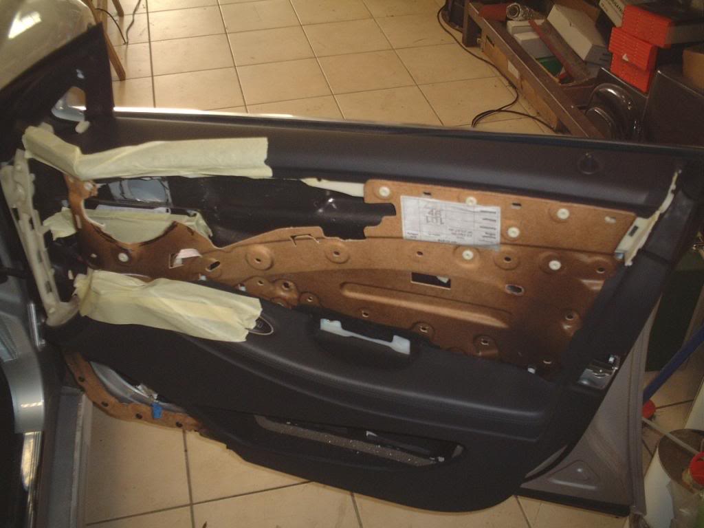

.. found a pic for you
here you see the cut
but it was during the progress, so don't take it as final

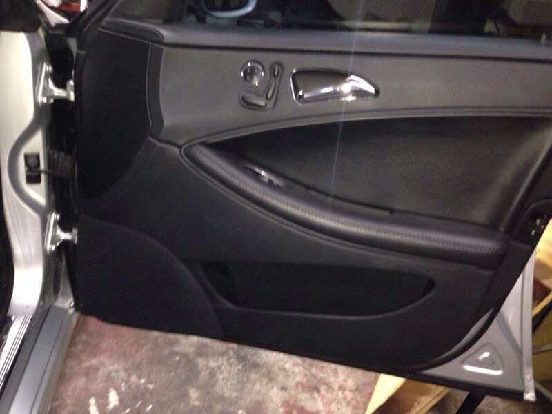

Update: 4" mids hybrid audio installed
ahah .. Hybrid audio, you mean HAT by Buwalda ? ..I talked with him some years ago. His goods are very well reputed.
Job appears good !
but next time post bigger and more pictures .. also of the mid-low, without grille
btw, did your shop fitted it without having to remove and cover again the door panel with leather ?
bet there are a lot of work-hours counting ..
