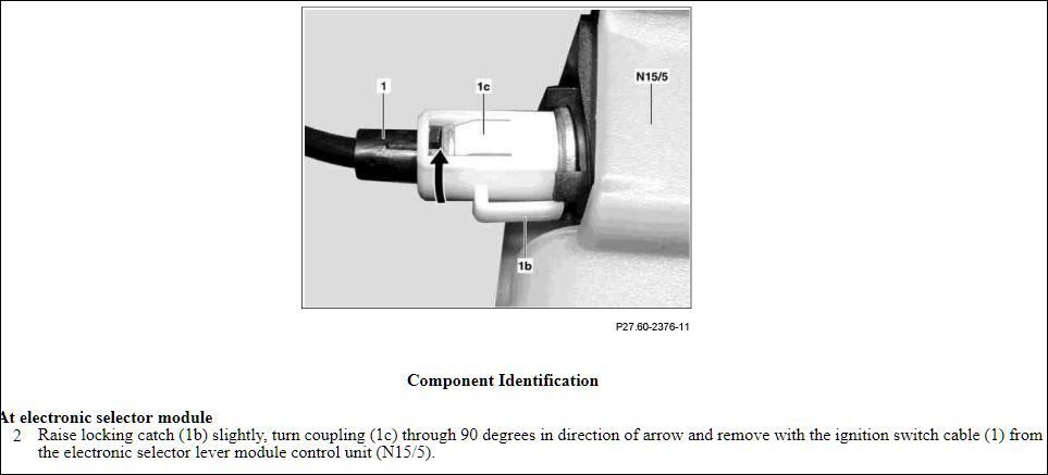

Normally plug & play when replacing with same part # any problems you will need to delete stored fault codes. Provide VIN if you want part # confirmation. Before replacing you can inspect internal board for defects that may be repairable depending on your skill set.
Posted by another member:
See attachments for replacement.
File Type: pdf
File Type: pdf

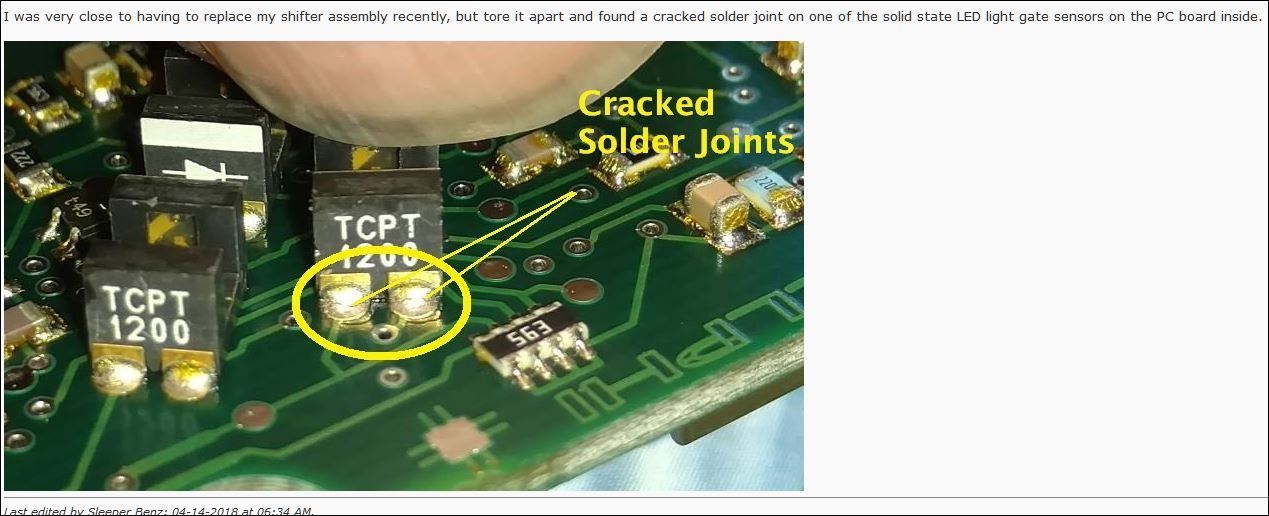

This is great info, thanks very much. I'll take it out and inspect for any obvious problems on the board.
My problem only seems to occur if the gear lever is operated many times on a journey when pulling up at junctions etc.

This repair seems to have worked for me. I stripped the unit down, couldn’t really see any bad solders as they are so small.
So I gave the components a wiggle and one of the LED gateways popped up, two of the solders gave way so they must have been cracked.
I re-soldered them, put everything back together and all has been working ok since. Fingers crossed that’s it sorted.
