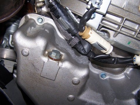

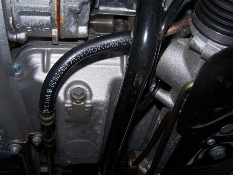

I changed my oil for the first time in my C55 yesterday (4,800 miles) - thanks to all who posted here for the advice. I thought I'd add some additional comments for those are haven't yet tackled that, but are planning to do so.
In terms of the two drain plugs - I've attached pictures below in case anyone is having a hard time locating them. If you go the drain plug method (which is the one I am used to) you will need to remove both engine shrouds (front and rear of engine). Not a big deal, but about 12 small bolts.
The one right near (in front of) the cross member (the first of the two pictures below) only drained a small amount of oil - I'd say maybe 1/3rd quart. Others have said they got a full quart out of there. My experience may have been due to the fact that I used ramps and drained from the rear plug first so most of the oil might have been positioned near the rear (main) plug. I did drain with the car at operating temperature (by the way).

Attached Thumbnails Resetting Service Interval Computer in C55?-front-drain-plug.jpg   Resetting Service Interval Computer in C55?-rear-drain-plug.jpg
