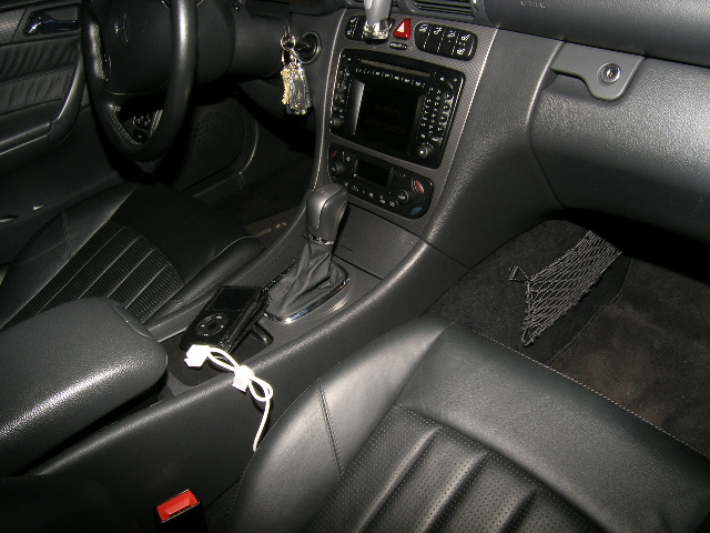

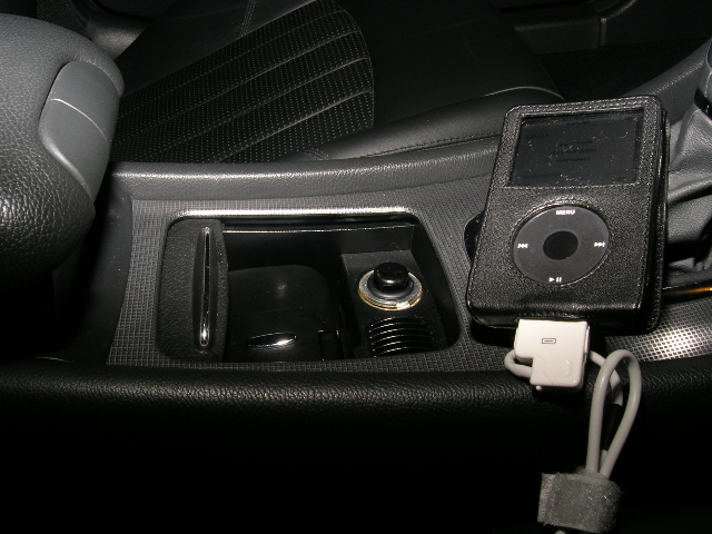

on my c32 I have the aux input installed. I had the problem where I have to crank up the volume just to be able to hear the music. well found the solution when I bought an Ipod video. I used this cigarette lighter adapter that is made by belkin, it has a built in Amp on it so you can just set it to the highest setting. and you dont have to touch the volume on your Ipod. I had this thing wired derect so I dont have a plug on my cigarette lighter connected all the time. the Ipod sits by my cup holder where I can change the songs anytime I want.
http://catalog.belkin.com/IWCatProdu...duct_Id=193794
here are some pics.
