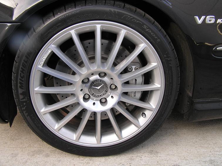

Originally Posted by MercedeSC32
I'm lookin into getting new wheels for my car, but don't know what size can i go with? i'm thinkin of stickin to strictly 18's but don't know what the hell the 8, 8.5, 9 are...can someone tell me what sizes of wheels can i fit on the car and what kind of tires also?
I picked up a set of 18" SLK55 AMG wheels.. They are 7.5 front and 8.5 rear.. Tires Michelin PS2's 225/40/18 & 255/35/18.. C55 wheels will also fit your car nicely.. If you buy aftermarket just make sure the offset is close to stock. Stock is 37 front and 34 rear..
If you want to maintain closest to factory get a 7.5 or 8 in front and 8.5-9 in rear depending on how wide a tire you want.
Here's some pics.. my car is lowered on Brabus springs.
Good luck..
