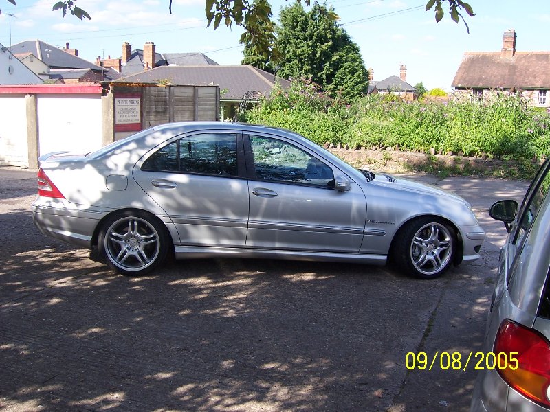

Originally Posted by jgsx
So do the 18" C55 rims fit on the C32? I love the C32 rims, I just wish that they were 18"
sig is with the 18" stlye IV's, perfect marriage.
