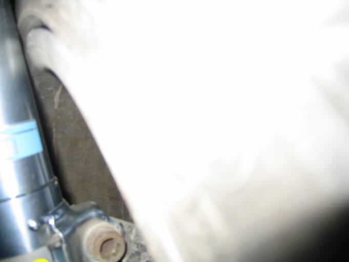

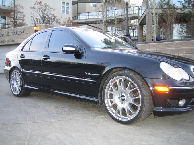

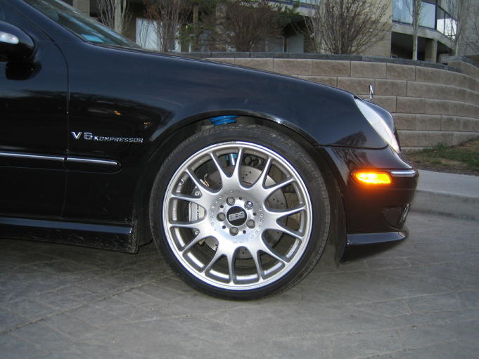

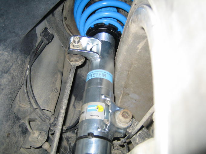

Well, here's some pics with the drop and the summer shoes on. The coilovers have not been "setup" because the dealership was confused with the clearance or lack thereof. I've included some pics and I know that Sdsilverm3 had the same type of problems with his KWs, but my drop is nowhere near as aggressive and i was wondering if this was normal and/or safe. The guy at the dealership said that the clearance is razor thin and wondered about the safety of this setup and said damage may occur under hard cornering or over big bumps (due to things like soft bushings used on these vehicles causing movement in the suspension and components then rubbing). Did other guys with coilovers experience these clearance problems and what are their thoughts. I think that Neal's setup even had some tire rub against the shock. Help! I'm dying to get this setup, aligned and then drive it!!
Have to say that without even really pushing things, the car feels tight.
I know that the car's dirty, but I just picked it up from the dealership and didn't have time to wash it

I just took the car for a spin and checked for any rub against the shock and there doesn't seem to be any even with the razor thin clearance. Hopefully I won't need any spacers.

Wow. The clearance on your car is the worst I've seen with PSS9's. What offset are your wheels? If you're already driving it around and it doesn't touch then I would say that it will never touch as mine has not either. It just looks super scary close.

looks like the tire is touching the shock. I wouldn't recommand you to drive like that. You should run a 3mm thing spacer to get some space between the rim and the shock.

like frank said.... i'd get a spacer too.

I second the need for a spacer. I wouldn't be able to enjoy the car knowin that the situation is what it is right now.

If those BBS's have a hub-centering ring you might be able to get BBS wheel specific spacers. They'll cost you a little more but sure do eliminate any chance of vibration you get with other spacers. Give BBS a call or FrankW might be able to help you out.

I think that the offset is 35, but i'm not 100% sure as i got the wheels with the car. I've already ordered a set of 5mm H&R spacers for the front, cuz it takes a week to get in. I also talked to a guy this morning that has done several of these coilover kits in MBs and will be taking my car to him tomorrow to have a look.

et35 offset is too little for the front wheels. The 5mm you ordered will be perfect and you can lower the front more. Just for reference Brabus 19x8.5 for W203 are et30 and Carlsson runs et28 to avoid the rims or tires contacting the shocks and springs.

looks like u could use a better sway bar endlink as well..

Furious, your V6 kompressor badge is about an inch too low. Doesn't look right.

the guy i bought the car from had the entire car debadged. had to "rebadge it."
