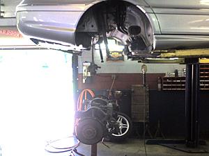

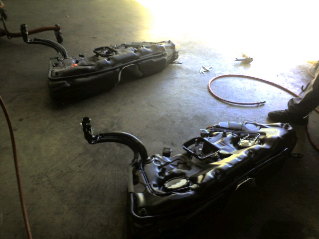

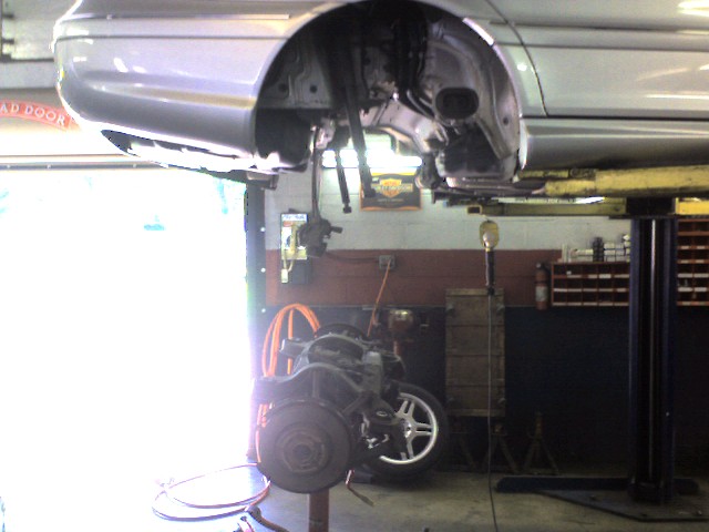

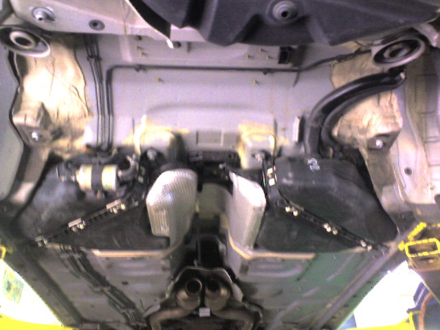

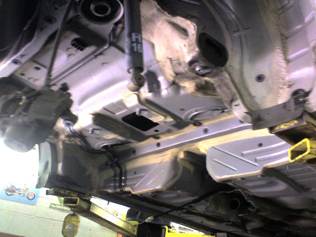

i just got rid of my c43 and moved up to a c32. well long story short i have had the c32 for a week and she dies on me. well i tow it back 2 work. come to find out it needed a fuelpump. all good right nope all amg car have diff tanks and the pump is made in2 the tank. so now it needs a tank well as you can see from the pics it was fun. thank god i get payed to fix my own car!!!!11.6 hours took me 5 1/2

if its a amg car it CAN ONLY GET A TANK. no other way. trust me im in the biz and i could not fine another way! i looked for a week and theres nothing out there. dont worry just save up about $2400 and your be back on the road. thank god for warrantys. mine was coverd. but there 2 pumps in the tank. one pumps it to the motor the other pumps it side to side to keep gas even in the tank and theres no way to take the tank apart to hook everything back up
