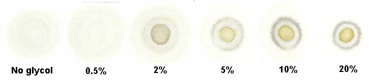

Originally Posted by ericpd
....How much do you think a local MB dealer will charge for the trans glycol test?......
Just to pay to get it done, I think it's at least $300 (if I can remember correctly). There are a couple of ways to test for glycol in the ATF. The first is the Schiff's reagent colorimetric test (that is the basis of the MB glycol test). You just oxidize your ATF sample to produce resulting aldehyde (if you have contamination) and then add Schiff's reagent to produce the color (purple-ish). If you don't have those reagents lying around, here's a good kit you can purchase:
Product # 2186400 from Hach. It's only about $85
It's not really quantitative, but you can still get a 'yea' or 'nay' result providing you include the right controls (unused ATF and ATF spiked with some antifreeze). I got this kit to verify my home-made analyses and it worked fine.
Alternatively, you can get somewhat of a 'yea' or 'nay' result by just applying a couple of drops of your ATF to blotting paper and let soak in for a few hours. The way the stain appears can tell you if there are tell-tale signs of glycol contamination. With considerable glycol presence, a ring develops around a yellow-ish / brown center. It looks like this:
....And where can I find a PDF of the owner's manual,... of all the historic documentation kept, the owner's manual is missing.
Create an account with MBUSA.com (owners online). You'll probably need the VIN to set up an account. Once you do that, you can get the pdf from there. It's about 27MB in size.

Thanks friend. Got it! Just discovered it has a brand new battery too! What is this clamp thing that fits over the battery? And there's a small hose/tube that's dangling right in front of it. I'm wondering what that connects to. It looks like whoever replaced the battery didn't completely clamp this thing back on. It has a filter on the bottom so I'm asuming it some kind of air flow through it,... maybe interior air. It's a long way from the motor to be air flowing to the engine. It's right up against the firewall on the passenger side and completely hids the battery. Looked like the filter was newly replaced as well,.... what is it?
Also, contaminents in the trans fluid,... am I looking for small metalic bits or something like that? That seems bad for any car.

Exactly what is glycol contamination, and where would this glycol come from? I'm more than way confused on this one.
Our transmission fluid gets run through the radiator system to keep the transmission fluid cool. In some of the radiators supplied to Benz, there is leakage and as a result the coolant (glycol) bleeds into the transmission fluid as it passes through the radiator. Transmissions HATE running on glycol. It will start with poor shifting, and then kill the transmission.
Your seat/wheel wiring is a serious problem. Maybe easy to fix, but definitelty whacked.
Thanks Fifth Ring,... after doing a search and reading some other threads on the glycol subject, I was able to catch up! I'm with ya on the wiring thing,... the way the seats operate seems backwards and opposite to normal expectation. All the button works by in reverse logic so to speak (well just the button that represents your butt). And like I said,... instead of opening up things to make in-n-out easier, the seat travels forward and the steering wheel gets in the way when you take the key out!

On the issue of the radiator and anti-freeze leaking into the transmission,... there were no danger signals identified. That's not to say I'll have this problem sometime in the future.
