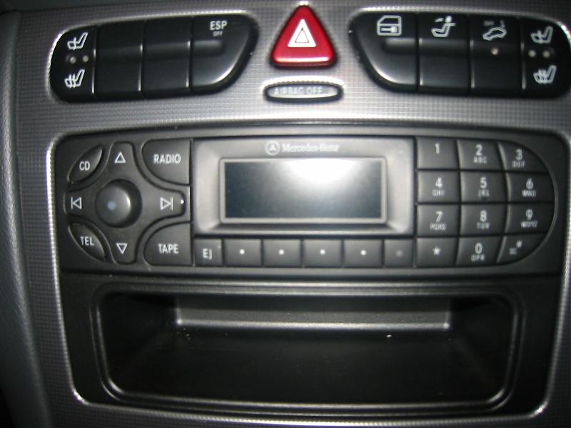

I don't know if 2003 models have the same head unit (non-nav) as the 2002 models. I have done a ton of research on this - and if you have the same head unit as me (see attached picture) then unfortunately there is no ipod or aux option, period.
I've considered buying a Comand 2.0 unit but they run close to $1000K - no thanks.
Personally, I use a $10 tape adapter for my ipod and it works great.

Mine looks the same. maybe I will just get the adpater that plugs into the lighter that charges and tunes to a radio freq not in use. Just have to scroll through the songs by hand.

I have one of those FM transmitters also - IMO, it sucks. Another way to rig it is to use the FM transmitter from a satellite radio unit - had decent luck with that.
