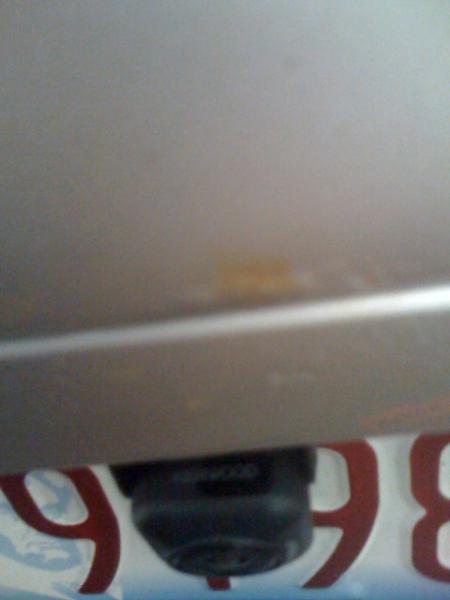

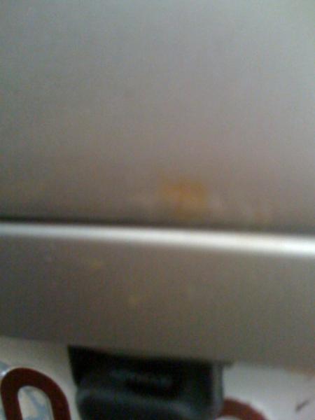

A little rust spot found...
I understand this car is like six years old but sort of confused why even a little rust spot would occur to a well maintained car...meaning its washed weekly and buffed once a year

wow it looks like the paint is actually bubbling too. The License plate area isn't designed very well. The tray is just a plastic piece that sits over the metal and it traps water. All that road salt in IL dosen't help either.
yes you are right its a little rust bubble I believe I found another areas similar to that....it suxs

Well, since you don't have a rust spot on the outside or a mark through the paint, it seems that you may have a problem on the inside of your trunk lid. You may be retaining water in between the license plate holder or it might be coming in through the middle brake light. I would check and see if there is any moisture in those spots. Sucks, but not the best place for cars.
