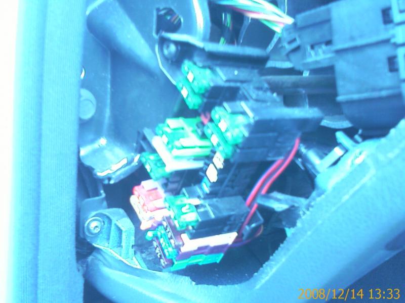

Unplug fuse #27 or #33, they are both 30amps so that way you'll have
the seat you like w/out looking like you're driving a lowrider
Not the best pick but you get the idea
And what's this $20 fix I just read???
