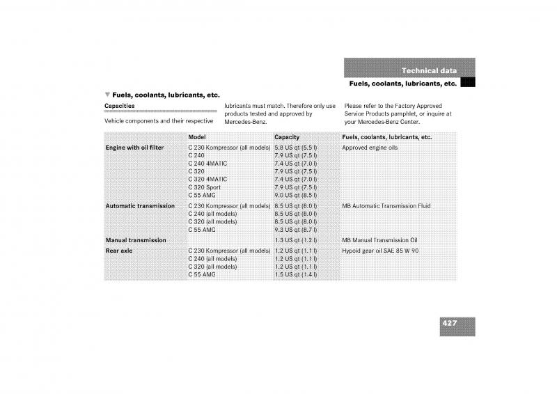

Actually, it is 9qts with oil filter. Here is a copy of c55 operator manual
