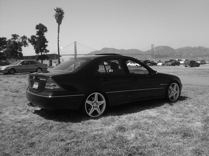

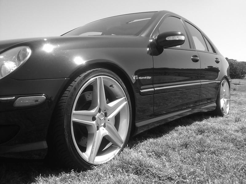

I also am runing with the HR's on my C32. When they were first installed I rubbed also. I was rubbing without anyone in the back I jack up the car and did some metal trimming with my Dremel.
It took several sessions of trimming until I got it almost perfect. I can run the car with two adults in the back and rub unless I hit a dip at speed.
I am also running with the "2 Dot" pads. I plan to bring the car up again and trim just a little more.
Btw... what offset are you running on your 19's. That would make a HUGE difference. I am running with a 35 offset in the rear.
Enjoy the pics!
