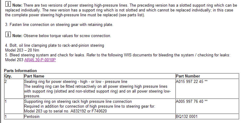

I pulled the o-rings at rack connections. They both feel, and look the same except for one difference. The pressure line o-ring is green instead of black... Can someone confirm or deny that both the pressure, and return line use the same o-ring? I have two "027-997-95-48" o-rings, but need to make sure things get done right. Star has this information listed... Even more confusing the part number listed in Star is different.
Attached Thumbnails Self repair of power steering pressure line...-starpsr.jpg
