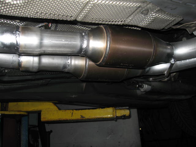

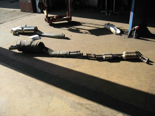

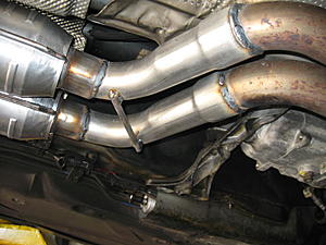

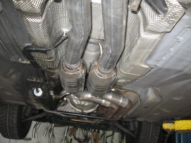

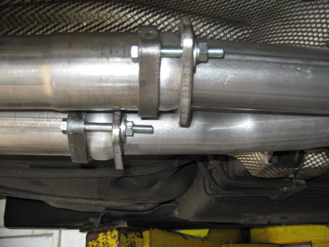

I have a 99 SL 500, actually its my dad's but I think of it as my own.
But my usual vehicle is a 98 BMW M3. After 12 yrs of faithful service, she needed a new rear main seal, new clutch, etc. I decided to do some mods, getting a short shift kit, stewart water pump, itg foam filter, and a milltek exhaust. Only problem was the size of the milltek pipes were 2.37 in and my stock pipes where it connected was 2 in. So I went to an exhaust shop and the guy told me that since I have 2 cats per side, 4 total, I won't feel the power. So he told me to cut it out and put in Magnaflows. So they did it and the car was more powerful than it was when I got it in 1998. More power quicker acceleration. I notice they used 2 different Magnaflows, 99334hm and 99335hm. Only diff was one is 2.25 in and the other is 2 in. He told me it didnt matter bec the main restriction was the restrictive cats.
I checked and tese magnaflows are 400 cell. so going from 2 cats that are probably 600-800 cell each to 400 cell was a big change. I had no CEL.
After a month, I decided to take things to the next level and get the HJS 200 cell. They cost me about $1k shipped from germany for 2.
So I went back to the shop and had him put it on, he had to weld the O2 bungs on the pipes. Now it is more faster and louder than with the Magnaflows. But not too loud, civilized because of my milltek.
I only had it for a week, but no CEL. I talked to HJS and this is what they use in germany for the M3s.
If I could do it again, I would have gotten the HJS. I dont know how long the magnaflows would last, but they were pretty good short term.
