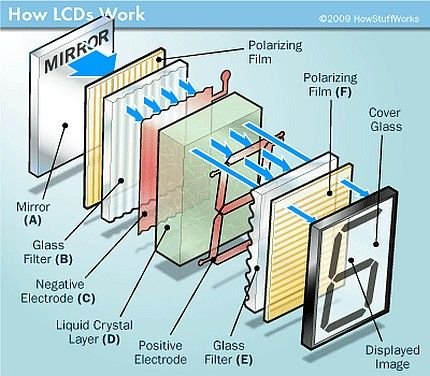

You can fix the problem with not being able to see with polarized glasses. Well if you have an old flat screen monitor from a laptop or PC, just pull it apart & the screen should have around 5 layers of film & 2 sheets are polarized. One of them should be closest to the LCD but if your not sure which one, then place one sheet at a time in front of your glasses until your LCD display can be seen. Then cut out the measurements of your display & insert it in front of your display, behind the mounting.
You can see the 2 polarizing films in the diagram.
