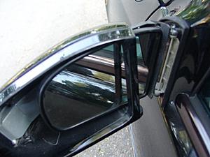

Just thought I'd post a recent experience I had that may save people a few bucks (a very few by MB standards) - my drivers sideview mirror turn signal would intermittently stop working, especially after coming out of a car wash, and finally appeared to have died completely. I ordered a new one ($35, RMEuropean), followed the service CD instructions on removing the mirror housing (more on that in a bit), and installed the new one. Voila, didn't work. First, I searched the fuse list and found that it's not on a fuse. Then I decided to go to basics and check contact quality. Here's the mirror w/o the cover:

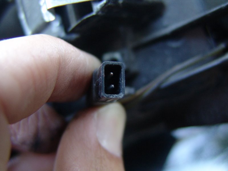

here's the plug:
A small piece of sandpaper and a mulitimeter probe cleaned up the two prongs, hooked up the old LED signal light, and viola, I've wasted $35. Assuming these LED's (just the drivers side, they're handed of course) ever actually die, I'm totally set.

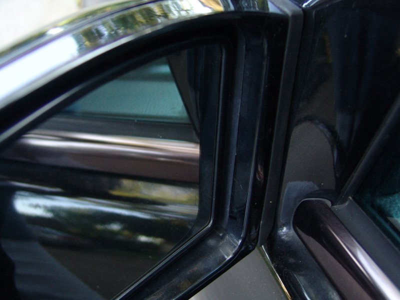

Lastly, getting the mirror housing off has been made to sound very easy in the service CD, but it assumed a base-level IQ which I apparently don't meet; the step left out is that the mirror must be positioned out of the way of the housing:
the mirror edge nearest the door must be pushed back out of the way of the frame nearest the door, so that the frame will not get hung up on it. I thought that I wasn't getting the spring clip sufficiently out of the way and struggled with trying to get the cover off until I saw this interference, after which it slipped right off:

Glad to be able to contribute, I get infinitely more out of this forum than I give back; all I could add would be that the key is to get the spring-steel clip pried out of the way while holding the mirror assy folded against the door - not a trivial task. I did it alone but it would definitely be easier if you had someone to hold the mirror against the force of the coil spring. I used a long, skinny, flat-nose screwdriver and kind of pried the sheet steel spring while pulling aft on the housing - once you get it started you can let it go back to its undeflected position and finish pulling it off laterally. Also, the screws that attached my LED light to the housing were very corroded, I had to be careful to make sure I got a good bite on them to get them out. Good luck.
btw the first pic shows the spring steel that needs to be pried toward the car to slide the housing off - it's a little hard to see with the housing installed, a flashlight helps.

I just signed up, and had resurrect this thread to say "Thanks". I'd been having mirror turn signal issues (2006 C230 SS) for a couple years. I'd replace one, and it would go flakey or stop working. A year ago, when I finally had both working most of the time, I asked my mechanic to fix the tabs and lock the mirrors back in place. Drivers has been solid. Passenger hasn't worked since. Last night I replaced it again. It worked for 2-3 flashes, then stopped. I pushed it in harder. Did the same thing. Tried again - no dice. After reading this, I took some sandpaper on a finishing nail to the contacts and sprayed them with DeOxit. Put the harness into the mirror. Worked. Bent the metal tab back out to secure the mirror housing, put it all back together - still works!
