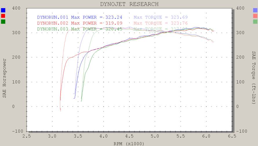

Well, I just got my SLK32 AMG back from the shop and thought I'd dyno it before completing the Evosport ODPS modification. The car is 100% stock except for the pullies. Stock software, exhaust, filters, etc. Gasoline used was Sunoco Ultra 94. I did ice the blower down for a good 30 minutes prior to the first run. Surprisingly, this made little difference, as my last run happened to be my best. Go figure.
Anyway, here are the 3rd gear pulls (correction factor of 1.02 SAE). The last run includes the A/F ratio. Everything looks pretty good to me.
Is this a factory freak or could there be a reason for the high numbers? A stock '99 Vette put down 302 at the wheels on this same dyno and my new (broken) 2003 Ford Mustang Cobra SVT put down 337 at the wheels on this same dyno just two days ago. So I think it's a pretty accurate dyno. What do you guys think?
I think I'm ready to complete the Evosport package and add a 75 shot of juice. I think nitrous along with the pullies are the best mods for this car. Other mods seem to be more expensive and produce little, if any, results. I'm talking exhausts, headers, software, etc. Can I add a 75 shot of juice with the stock fuel system? That's what I'm wondering...

Looks good Marc! Call me.
FYI: Marc's SLK32 currently has our ODPS on his car, but he has not yet completed the installation of the IC reservoir upgrade.

BTW, did I screw up by making the pulls in 3rd gear and not 4th? I think you want the gear that's closest to a 1:1 ratio. On the SLK32 AMG, 4th gear is exactly 1:1. Oops. So would my results be higher in 4th or 3rd?

Idealy, you want to use 4th gear for your dyno runs, but few dyno operators have the equipment necessary to obtain accurate 4th gear readings. Without heavy-duty fans, the car will quickly heatsoak, and have readings lower than real-life (street) experience. For this reason, we have chosen to post our dynos in 3rd gear, as most others will not be able to accurately do fouth. HOWEVER, using a 4th gear pull should yield about 10+hp more if done properly.

Hehe that's a very strong car you have there. It seems the C32 comming out lately are stronger than the first delivery C32 's.

Good numbers! just shows what 94 octane can do for you
