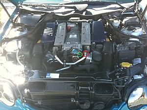

Zep - not really mate. I've uploaded a photo (forgive me "AHO"). The RED circle is pipe that was cut. The GREEN circle is roughly where the pulley retainer arm/clip is and the BLUE is roughly where the SC pulley was dented.

Was the pulley that came loose, the ribbed guide pulley just to the left of the S/C pulley, or the smooth guide pulley underneath them?
Are you running an aftermarket pulley kit, or the stock pullies?
The silver "finned" box just down and to the right of the red circle in the picture, is an AMG-specific oil cooler. If you have oil and coolant mixing, it's probably from that part getting damaged, IMHO. Relatively expensive part, if memory serves.
Sorry to hear of your situation - good luck with your repairs.
Not sure what the answer to the first one is mate.
Stock pullies...I don't reckon I'll do anything to her now (230,000kms) but my next AMG (either an '04 C32 or an '06 C55 hopefully) will be chipped.
Mechanic said my I/C was leaking, which was why my coolant had some oil in it.
Apparently it's my SC clutch which is buggered. Having to wait nearly two weeks for the parts to come ex-Germany...and driving an A160 in the meanwhile...whoopee.

Sounds like what happened to Juan a month back. The supercharger pulley rivets gave out. You probably didn't need an entire clutch, but instead just the pulley. Getting it repaired at a shop would have been much cheaper, or even going aftermarket such as the Eurocharged. The circled red pipe is for secondary air pump and can just be tapped. Only hot air runs through it.
