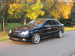

Renntech Monolites (Pictured) are very light and quite strong. 19''s weigh around 19lbs each.
Attached Thumbnails What are the lightest wheels/tires combo out there for W203 chasis?-c55-019.jpg

Originally Posted by wawy
Renntech Monolites (Pictured) are pretty light and quite strong. 19''s weigh around 19lbs each.
I wish I could get these but I need 18" because my h&r coilovers is setup for 18" only.
Old Nov 10, 2012 | 11:29 AM
wawy's Avatar
Posts: 1,687
Likes: 28
From: Western Canada
2013 C63 AMG P31, 2014 GMC Sierra (6.2)
They come in 18'' also
