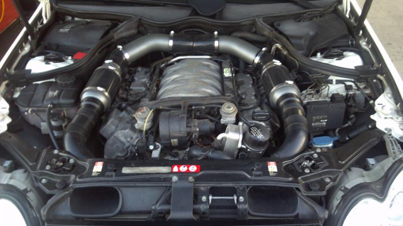

[/ATTACH]Ok, new pb...12.489 @ 111.77 with a 1.894 60'. Timeslip is in the drag racing sticky, won't let me upload again. I think my times suffered last week because I was launching too high with the Hoosiers, this was with a 1200rpm launch and short burnout. Of my 5 runs, I had the 12.4, four low 12.5's and one 12.8. The 12.8 was a high rpm launch just to confirm my belief that I was loosing time with the 2000rpm launches. Tire pressure was 20psi all day; I figured I'd sort out my launch rpm and then play with pressures later. Cecil is open until the 3rd week of December, so I have a few more Saturdays to play. My plan is to get the cams in and get a retune before they close, but we will see. Dragtimes hasn't updated the weather yet, so I can't give a DA, but it was 55 degrees per the dash temp.
On a side note, there was a White C63 there...only glimpsed him in the staging lanes once and then he left. I spoke to a guy with a CTS-V (11.8's) that said the C63 was running 12.0X's. Bummed I showed up too late to chat with him.

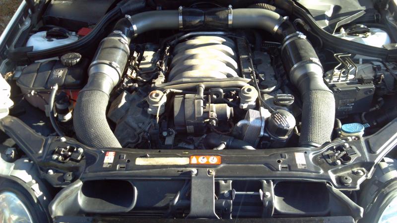

91RS, I have a pic below of the whole setup. $800 isn't cheap, but for me, in comparison to the only other aftermarket alternative, it was a no-brainer. I don't think you need for the 55K airboxes since you have the blower, it comes with 2 inline air filters. unfortunately the E55 setup is $200 more, but maybe you could mod the SLK setup to fit? I'm going to see if the local dealer has the shorter CLK intake tubes in stock tomorrow, that should help a great deal as the C55 intake tubes are too long for the SLK55 setup.
As stated above, I'm not sure if it'll work with a klee betreza, I don't see why it wouldn't but then again I'm assuming that the E55 setup they sell uses the same aluminum elbow. Might want to check with Rob @ Needswings to know for sure. Either way,for me, it was nice to have another option!
For everyone else, I will let Rob @ Needswings know what changes I make to fit this on the C55. Hopefully they can put out something that will be cheaper than the Renntech airbox and flows all we could ever need to boot.

Ah, ok. I didn't realize you did use the whole setup. I mean $800 was expensive to use part of it. The E55 airbox setup is very tight on the C55 and the splitter touches the wiper cowl panel and it creaks when it's cold. It was fine all summer, but now it's starting to make noise again and it's a little annoying.
Your car is stupid fast for being N/A. I would have been completely happy with that.

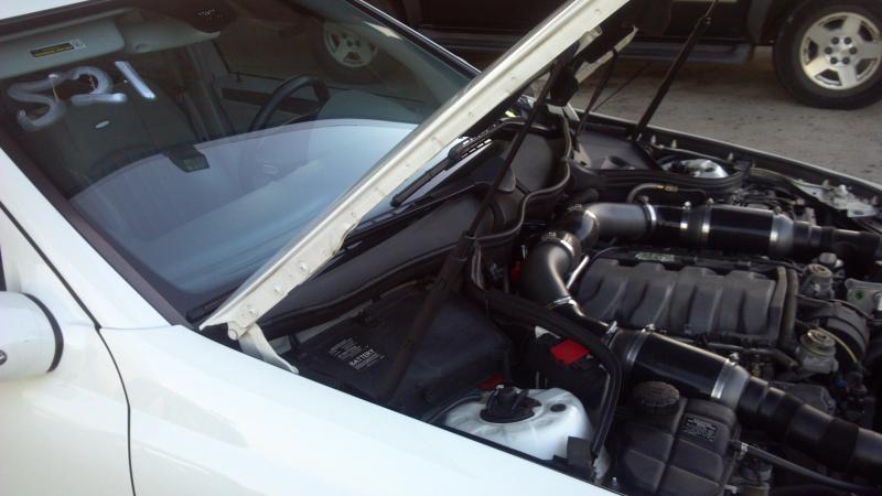

My Renntech CF airbox has no clearance issues. Being slow never looked this good.

No doubt about the Renntech airbox looking better. For all I know the Needswings and Renntech flow the same. Wish I coulda squeezed a dyno in, but by the time I get the cams in and a retune, who knows what contributed how much.

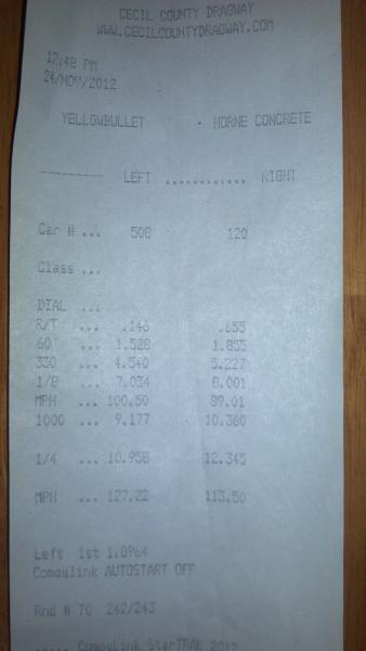

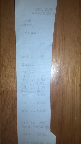

12.345 @ 113.5 withat a 1.855 60', best trap of the day was 113.78.
I'll add the pic tonight
Not sure why they cut the one slip in half...guess their printer ate the other guy's slip...it was a modded WRX that did about a 13.0. Jesus those things can launch. Wish I knew what his 60' was!
Attached Thumbnails FINALLY got the Crank Pulley and intake installed...-2012-11-24_16-18-04_150.jpg   FINALLY got the Crank Pulley and intake installed...-2012-11-24_16-18-11_996.jpg

Hoosier DOT Drag Radials, 225/50-16 on 16x7 Sparco Asseta Garas. The "225's" were only 1/2" narrower than the 265 street radials I got the 12.79 with, plus there are E55's pulling awesome 60's with 245's and 255's. I'm nowhere needing that much traction yet *sigh*
Added slips above btw...^^^^

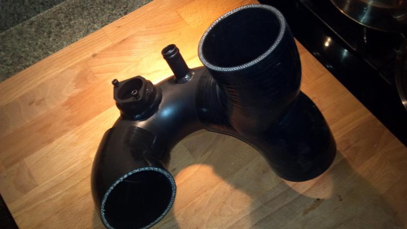

About the intake, I was informed br Rob @ Needswings that I had installed the tubes to the Y backwards (oops lol...guess I got a little brain dead after 2 full days wrenching on the car). I swapped the tubes, but also installed the shorter kevlar CLK tubes, fit and appearance are MUCH better (pic below) when you install it right and you have the slightly shorter tubes. Thanks again for the tubes Nachtsturm!
I still need to install the badge holder, but I'm waiting on the cam tools to pull of the valve covers and intake manifold to paint them VHT Burnt Copper (see attached pic, opinions anyone?). I figure I will paint the calipers to match when I get around to that point on my very long list.

I only have 200 miles on them, so I'm not sure how much adaptation the ECU will make but I can understand why some people say these are too lumpy lol. You can feel and hear the difference, but it's still within the limits of what I consider acceptable. My only complaint is the feel when it's in gear and stopped or rolling at walking pace with no throttle. It's not jerky enough to be visibly noticible, but you can feel the lope. If the ECU doesn't end up smoothing that out, I might see if Eurocharged can bump the idle up 100 rpms or so when I do the dyno tune.
The install actually wasn't bad, just time consuming. I was using the Kleemann installation instructions you can find and download online. There are a few things that would have been good to include in the instructions but overall they are pretty easy to follow.
We started the work Sunday around noon and basically was finished the passenger side that day (or so I thought). Finished the PITA driver side on Monday but then discovered when looking at the StarTek service DVD that you are NOT supposed to reuse the camshaft bridge bolts...no mention of this in the Kleemann instructions. Not only that, there are different torque specs in Startek for the C55 cam bridge bolts than the C32...the Kleemann instructions use the C32 specs. So, after a bit creative cursing, I had to get on the phone with a dealership to track down the bolts. I ended up having to drive 2 hours from Pennsylvania to Baltimore Monday night, then Alexandria Virginia, next Germantown then Hagerstown and back to PA Monday morning since no one had everything I needed. I replaced the cam gear bolts and chain tensioner while I was at it and torqued everything to the C55 specs. It could have taken one long day without the bolt issue but I was painting the valve covers too.
Performance wise, it does seem to pull harder up top, but it may be exagerated if I lost anything down low. The whistling sound from the intake seems more pronounced now as well, hopefully that means she needs more air now. It's supposed to be dry and 40-50 degrees this saturday, I'll find out then
