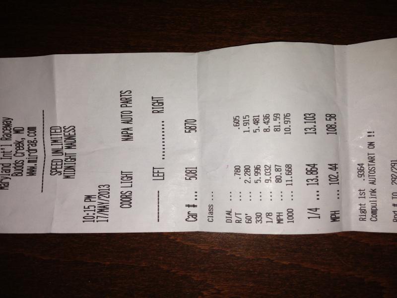

Here's the time slip
Attached Thumbnails Went to MIR with C55 AMG- 13.103 @ 108.58, but have some concerns-photo.jpg

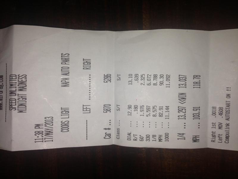

Run #2 13.297 @103.91
This is were the traps speed suffered greatly. Makes me worried about something.
Attached Thumbnails Went to MIR with C55 AMG- 13.103 @ 108.58, but have some concerns-photo-1.jpg

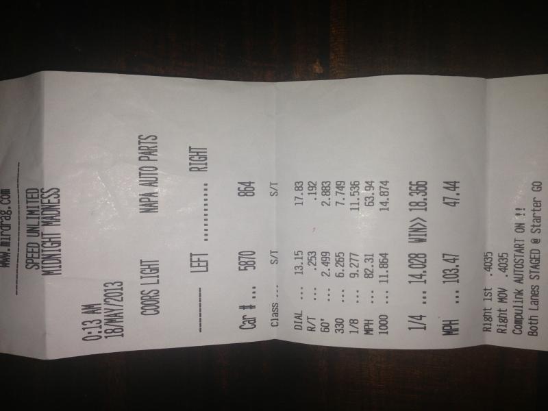

Run #3 14.028 @103.47
Lots of wheel spin, not sure why. 2 runs before not a hint of wheel spin. All parameters were the same for the 3 runs. Auto-S w/ ESP ON for every run.
Attached Thumbnails Went to MIR with C55 AMG- 13.103 @ 108.58, but have some concerns-photo-2.jpg

Thanks for posting the slips 1320, believe it or not, the .061 second difference between run #1 and #2 is a big deal as far as ET. The .584 second difference between #1 and #3 is HUGE as far as ET.
You gain between 21mph to 21.97 mph from the 1/8th to the 1/4 or all 3 of your slips...no wheelspin once you're past the 1/8th, so your power is consistant; the variation in your ET should be down to your launch.
