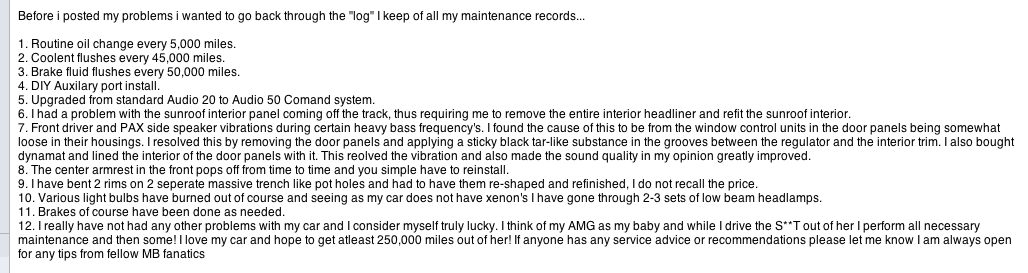

I took my door panels off twice for the various mods that I did. Each time I fiddled with the speakers to fix the rattles, no luck. The third time I used the materials in the rattle kit supplied by MB and the directions given in point 7 from another poster here (not sure of his name, my screen print didn't capture it). Not until I did what point 7 says did I eliminate the rattles in the two front doors. The OP also mentions that it greatly enhanced the sound. quality.
