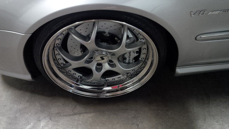

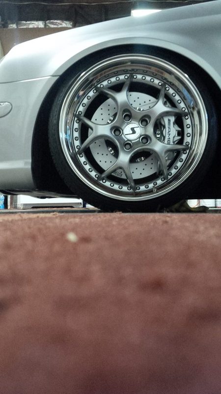

Old May 9, 2015 | 05:14 PM
greekspec2's Avatar
Joined: Aug 2011
Posts: 490
Likes: 8
From: SF Bay Area
2005 C55
19x9 et22 3.5" dish 215/35/19
C55: suspension upgrades?-10996053_10153323744548035_9072973460813456788_n_zpsrexhpvlx.jpg
C55: suspension upgrades?-img_20150508_060724_zpsjxkosnvx.jpg
19x8.5et20 with 12mm spacer 1" dish 235/35/19

That little amount of width makes all the girls sad. 215 fronts and 235 rears? I'm running 245 and 265s respectively and want/need more.
