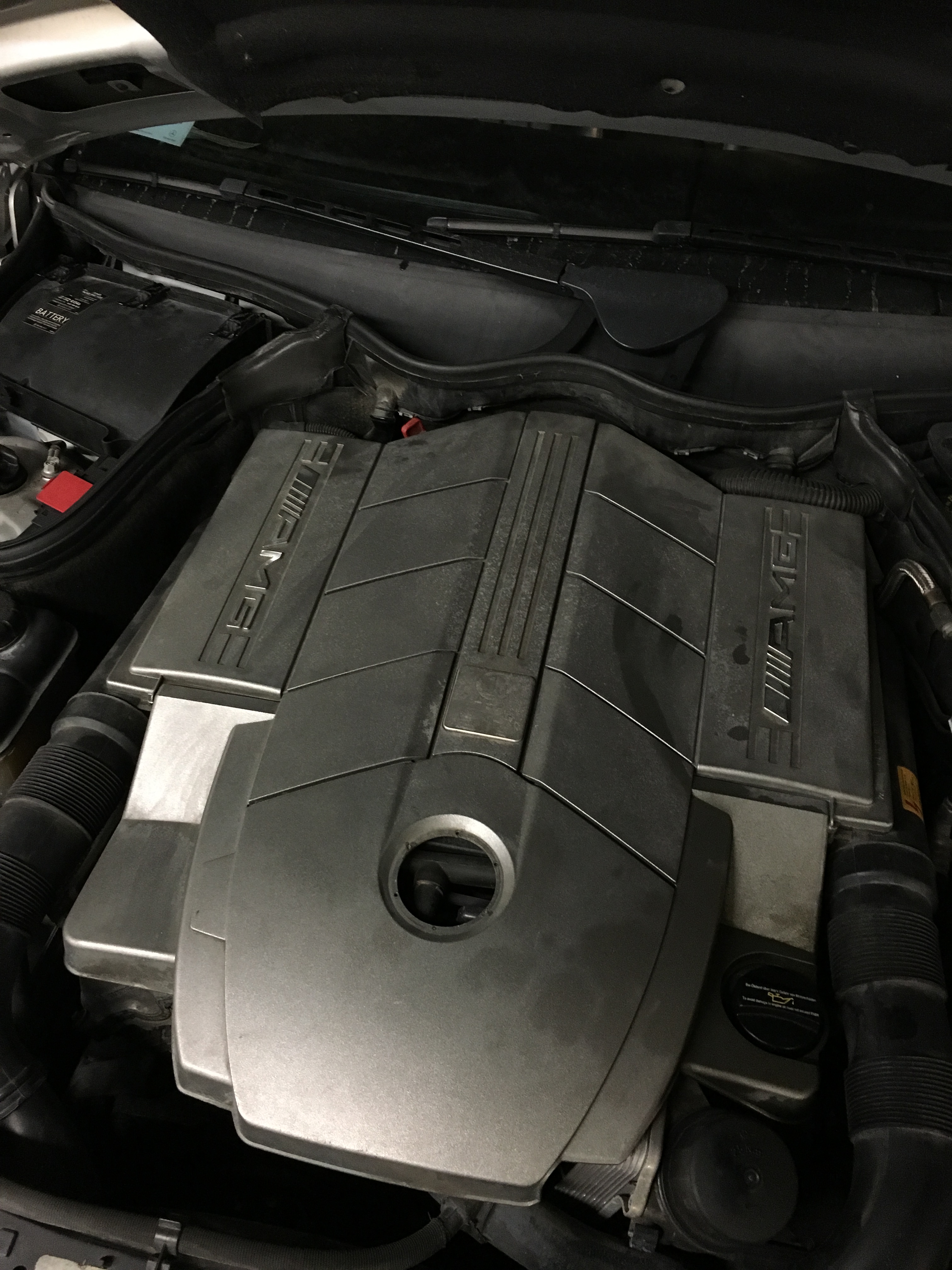

Thanks everyone for the comments. I ended up taking the car to my shop (http://www.mcnallyauto.com/ - site is mysteriously down all of a sudden) to get it looked at. Been going to this shop for 4 years now. Head mechanic/shop owner (Charlie) put it on a lift and said it looks like a rear engine oil leak and would take 3-4 hours just to diagnose. Said it's a big job and the entire engine would need to be lifted out. I took his word for it and brought my car back a week later before I left town on a business trip. I dropped car off at the shop Monday morning (the 18th) and took off to the airport.
Went in this morning and picked the car up. See attached invoice for details on the job and what I was charged.
I have a tracking device on my car through my insurance company (auto merit program). The car was driven:
29 KMs on Tuesday (19th)
64KMs on Wednesday (20th)
44 KMs on Thursday (21st)
I got the car back it was dirty and covered in salt (i carwashed it the day i took it in). I gave it to them with over half a tank and got it back with less than half a tank. Mechanic mentioned to me they drove it a little to test it. I don't have GPS details, but most of the driving occurred between 6:30AM - 9AM and in the evening after 5:30PM.
Is it normal for a mechanic to put nearly 140km's on your car for a job like this?

The invoice mentions the engine was shampooed, it clearly wasn't.
The MB emblem on the engine of the car is missing.
