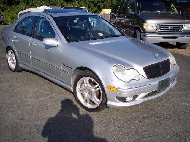

Welcome please post picture of your ride
Old Apr 2, 2016 | 03:09 PM
Supercity95's Avatar
Joined: Apr 2016
Posts: 13
C32 Amg
2003 C32 Amg

nice looking ride

Thanks
