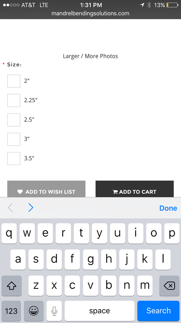

Old Sep 24, 2016 | 01:32 PM
Ackime Snow's Avatar
Joined: Sep 2016
Posts: 108
From: New York, NY
C55 AMG
Originally Posted by Amir_AMG
I have the kleeman headers and downpipes...they will get rid of the primary cats only, I was just suggesting getting rid of the secondary cats and resonator for better flow and sound..make sure you get a tune as well
The link you posted for the high flow cats, what size did you get? See picture

Old Sep 24, 2016 | 06:09 PM
Amir_AMG's Avatar
Veteran: Air Force
Joined: Dec 2006
Posts: 1,308
Likes: 62
From: Bethesda, MD
2000 SL500
I got 2.5" high flow cats, make sure they are pretty short in overall length, as there isnt much space to work with (at least on my CLK) the magnaflow ones I got were 8" overall
