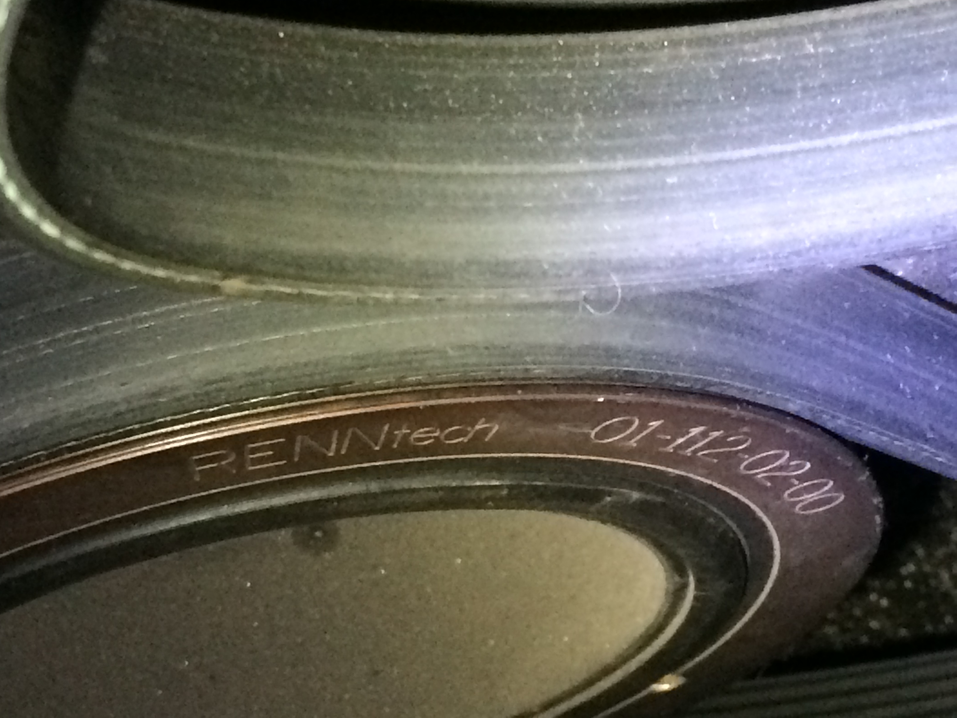

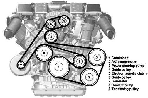

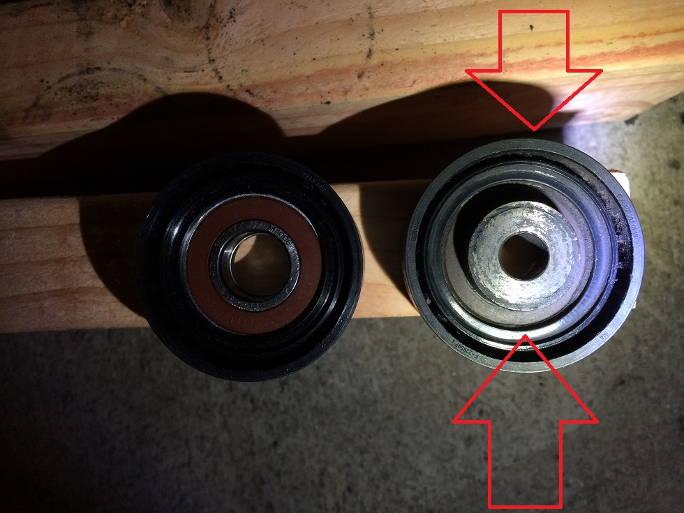

So, I fixed the SC bearing only to now be able to hear the idler/guide pulley going (below the SC guide pulley - #4 on the diagram). However, it is definitely not stock. I pulled the number off it and ordered the part with 1-day shipping, but the original pulley center piece seems to have a welded spacer on it so they do not match up (see photos, the stock replacement is on the left, the old pulley I am replacing is on the right).
I think it belongs to the Renntech pulley kit, but cannot find any others with the same pulley. Unfortunately, Renntech closed for the day but I am hoping to know by the time I call tomorrow if it is theirs, so I can get rush delivery on it.
I bought this car (04 C32) used without any documentation on the mods so I am having to figure it out as I go. The Renntech crankshaft pulley is marked 01-112-02-00. The small guide pulley I am replacing is marked MB A 137 202 01 19, but again, the metal center is different than stock.

Are you sure the center part is welded on? It might be a bushing that needs to be driven out and placed on the new pulley. What does the flip side of those pulleys look like?
No, I'm not certain. But I cleaned it and then unsuccessfully attempted to bang it out (stupidly), which is why I can no longer drive the car. I'm certain in the process, I damaged the pulley more. It seems like it is welded.
Here is a photo of the rear. The left is the incorrect INA replacement I just bought and the right is the pulley that was part of the kit that I am seeking the replacement for. The INA looks a bit different with that metal plate in the center. I imagine the oem MB version looks exactly like the modified pulley without the spacer welded to the center.

They are different size holes, so there must be something that fills the new pulley in order to fit the bolt. You might check online or with a dealer to see if there is a bushing you are missing. I don't recall how that pulley goes together or I could give a straight answer.
Since the old pulley is trash, you may need a press, and some heat to get that bushing out. Or just get the right part for the car.
If you have access to a WIS or the EPC, you could find the correct parts for that pulley. I could, but not here at work.

Yeah, turns out it is a separate spacer. Perhaps because of the heat from the high rotating rate, it somehow welded itself to the ring of the bearing on the pulley. kbobb999 - I really appreciate you taking the time to try and troubleshoot this with me.
For those who stumble upon this thread later down the line:
I emailed Renntech pictures and also called them. They just got back to me and they are providing the spacer and updated idler pulley. It will cost $10+$33+ expedited shipping. So if you are in the same boat, give them a call for the idler pulley replacement. Luckily as of now, they are still able to get the components for this kit. ...Phew!
