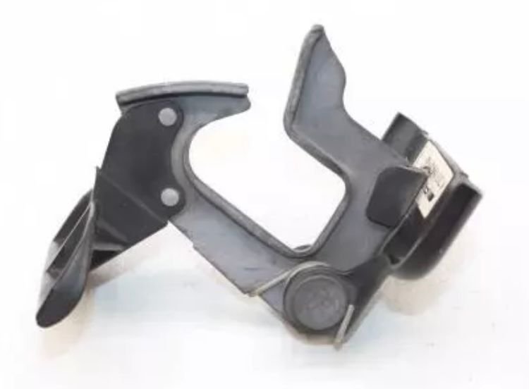

I need the original hood latch. Anyone know the part numbers or other cars they might have been used on?

You will still need a center support and the correct hood release for the C55. The CLK hood release won’t work. You could potentially make one out of a second CLK release by relocating the handle like AMG originally did:
Also, the C55 hood had threaded studs on the underside of the hood to mount the upper strip, but you could probably just glue it on.
