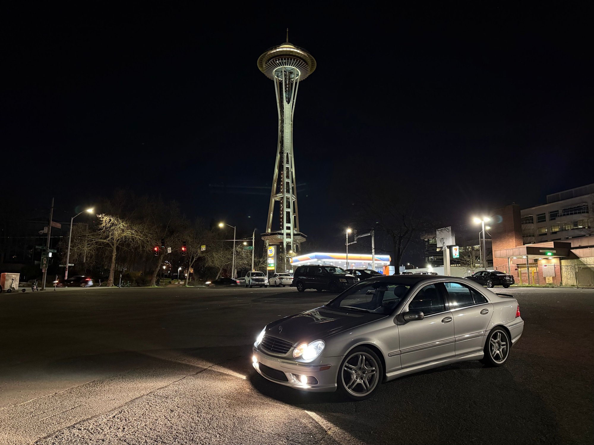

Thank you all for your responses.
I'm happy to share I picked up a C55 AMG this weekend. I brought it home to Colorado and had a mostly uneventful trip.
At one point in the Utah desert, I lost all gauges, blinkers, power windows, and climate control. The steering wheel returned to its raised position to exit the car. However, the engine and transmission kept working. I made it about 30 miles (in which the odometer did not read a single mile, despite displaying the miles) to the next auto part store. I restarted the car and everything came back to life. I had them check the alternator and battery while I tested all the relevant fuses. First thing the guy from the auto part store said was "I hate German cars"
Luckily, the alternator was fine, but battery tested low. Slapped a new battery in and the rest of the trip went smoothly. I had a couple of power surges where I could see the headlights get brighter for half a second. Then yesterday, I drove over a pothole going 10 miles an hour and same thing happened where I lost all gauges. I checked the battery and it was not installed correctly so it was flopping around in the engine bay. The person who installed the previous battery did not properly secure it, and while replacing it in the parking lot of the auto part store I didn't realize there was a bracket in the tray. I'm hoping that's solves it.
It has a few small issues, namely valve covers are leaking, the key fob does not work unless you are really close to the infrared sensor (checked fuses in the trunk and they seemed fine), driver's heated seat bottom does not work, and there's a whining noise that matches the revs, I suspect one of the pulleys, but haven't properly diagnosed it just yet.
Nothing I didn't expect out of a 20-year-old German car. I'm loving it. It's an amazing freeway cruiser, sound is great, and it is very athletic! It has some deferred maintenance that I plan to address over time, but I started with an FCP Euro. My plan is to switch to Liqui Moly 5W40 - PO ran 0W40, engine filters, and alternator voltage regulator to hopefully address the power surge. The part is so cheap it is worth to do even as preventative maintenance. Oh, and windshield wipers
I will update my first post with additional items to check for so this can be a helpful guide for anyone looking to buy one of these cars.
Cheers!
