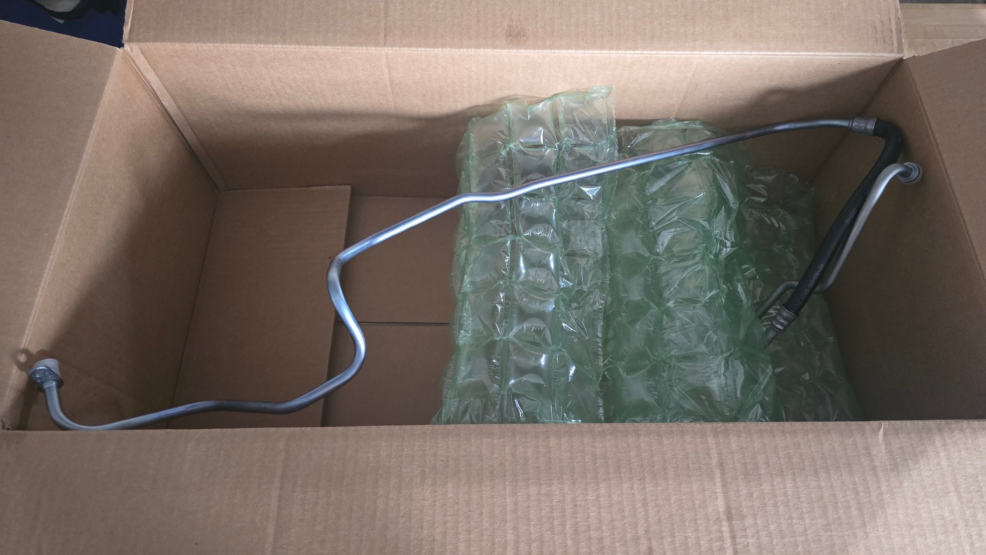

Transmission Cooler Lines These need to come from an M113 + 7G-Tronic CLK500 (2005–2006 in the US). Part numbers: A209-270-48-96 A209-270-47-96 These route correctly and connect properly to the 722.9 and original radiator.

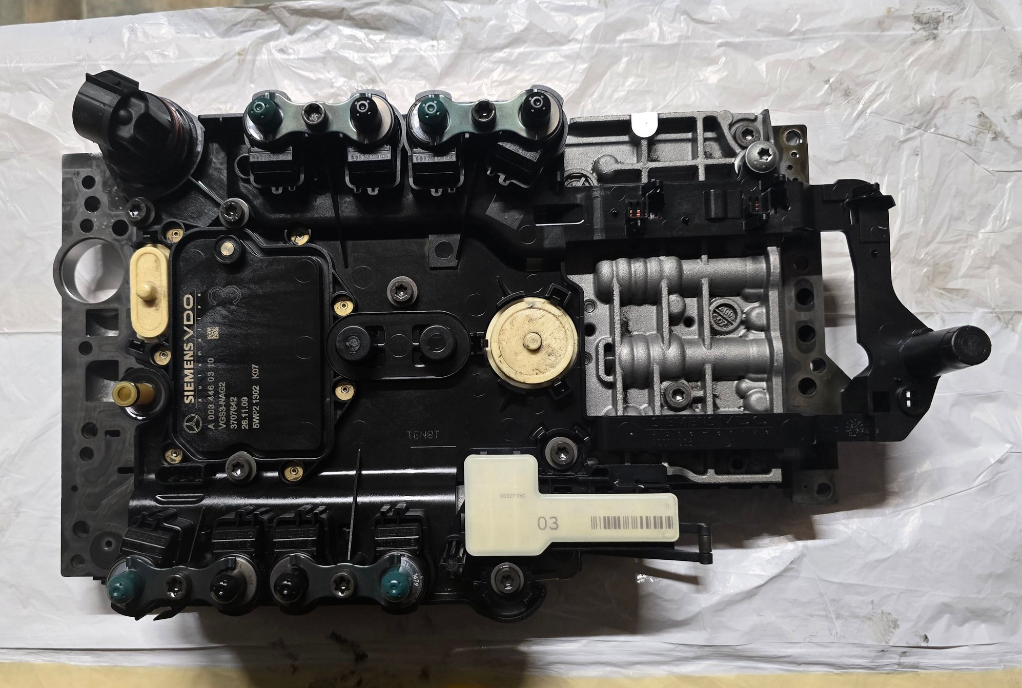

--- VGS (722.9 TCU) The VGS is the transmission control unit and conductor plate for the 722.9. Unlike the 722.6, which uses a separate TCU mounted elsewhere in the car, the 722.9 integrates the control module into the transmission. This will need to be reprogrammed to work with your vehicle. It is VIN-locked, and certain parameters (such as gear ratios) must match your setup.
VGS and valve body connected.

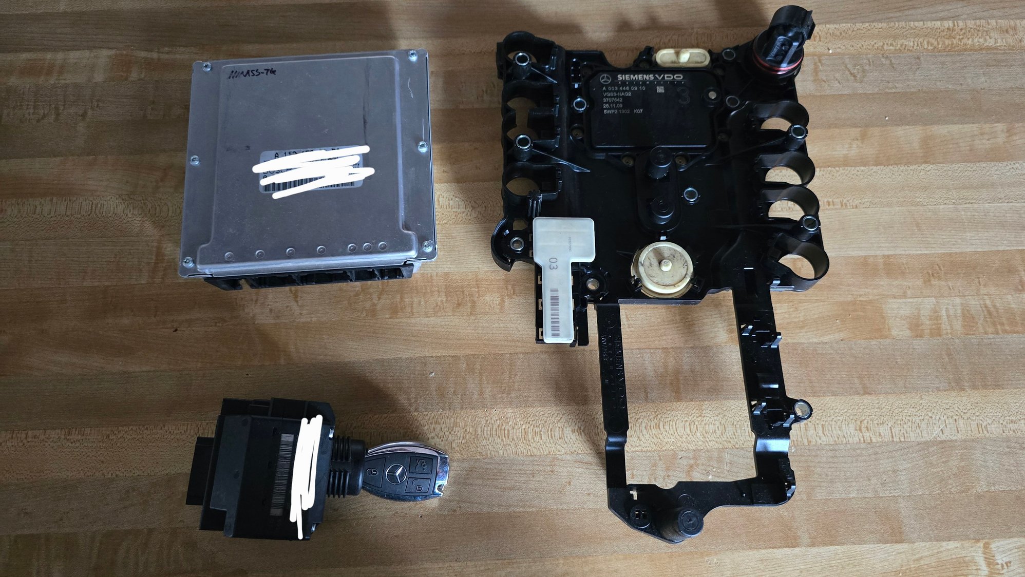

I got the vgs, key, ecu, eis back from the mercedes swap shop today. I plugged it all in, and its working great! Dash shows all 7 gears, xentry scanned, cleared codes, range select is working, its all working great! I need to finish up a few small things on other parts of the car, but first test drive coming very soon!
