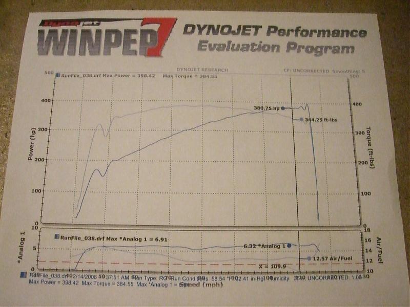

Hey Carl,
Long time no see, we had some fun on the way back from Maryland, hope to do it again sometime soon this March or April. Right after we got back from Maryland(13.21@106.37) I had my ECU reflashed, removed the primary cats like you told me and did a 12.80@108.72(click on signature to see video) at Englishtown on Nov. 2, of course it was much colder and I had some DR's on. Since last Nov. I did some major mods so I'm hoping to do some better #'s when the track opens in March, I hope you'll come out with the C55
ps. this is my latest dyno

I believe Dan **** used the BEGI brand FMU for his CLK application. I think I remember reading about it. If I remember correctly Mario had the Vortech unit. I have this same adjustable Vortech unit as well. I installed the preset FMU that came with the kit though. We were missing a part for the adj. FMU and the supplied one ended up working ok for the about of boost I was running. 4.5lb-5lbs. The begi unit looks as good and should work as well as the vortech unit.
About the A/F issues...I starting to remember if it was the FMU adjustment or the meth/H20 system that made this issue go away. I know that the FMU issue came up early with his install and it was a neccesary to make the power and safe A/F. I'm starting to think that he told me the meth/H20 was the thing that fixed the part throttle issue..I'm gonna give him a call this afternoon.
Old Apr 12, 2008 | 01:58 PM
  #50
silence's Avatar
Joined: Dec 2007
Posts: 1,100
From: Rochester, MN
sounds like airplane
thanks
it really is working 95% of how i want it to- i just think it would seem a lot safer richer and the occasional hiccup under part throttle is annoying (is it the knock sensor???)
also, about 1 in 10 times i back up and it shuts off... lol. honestly though i tihnk that's temperature related and who knows.
